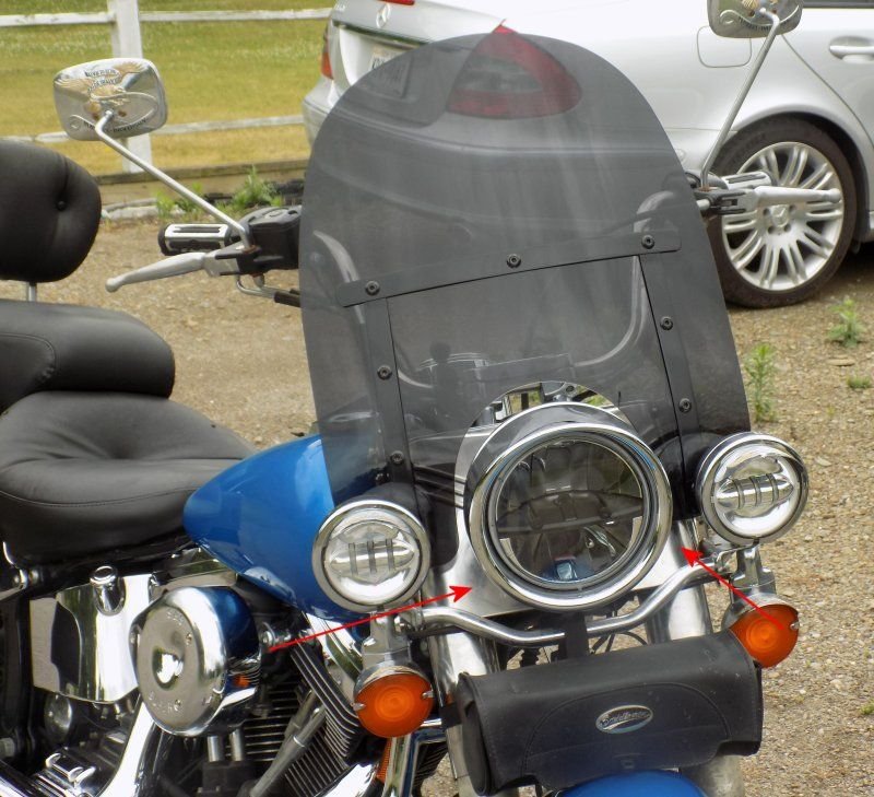

I need to get a replace of what is "Arrowed" (front and back) in the picture below but don't know what it is or is called. Can someone shed some light on that please?
The chrome stuff that goes behind the headlight ........
It's called the front panel, part #67808-86. If it is OEM, it's buffed stainless steel. I believe it is a discontinued part, so you'll have to go to eBay and find one in good shape. It was used on various FL softail models from '86 until at least my 2003 Heritage... I'm guessing probably until '06/'07ish...
There are a couple repop chrome ones on the market...

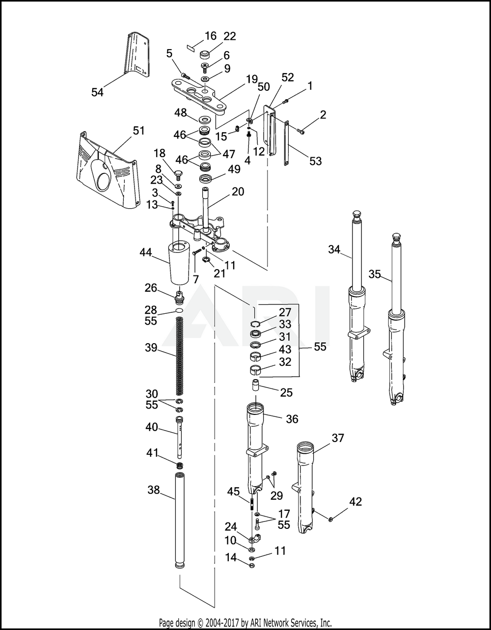

The OEM front panel is #51 in the pic below...

Ref: 51
P/N 67808-86
FRONT PANEL BUFFED STAINLESS STEEL

Thanks Gents - and yep, that is what I need as well as the two rear bits, actually it is the rear bits I need more - had to make some pretty ahh serious mods to them to get the windscreen mount stuff to fit
