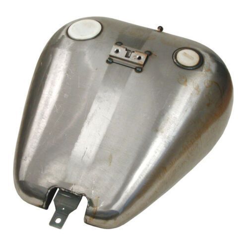

Anyway, I've lost the riding season completely trying to source out an OEM replacement. I found a proper replacement listed on eBay from a re-seller in Germany but his supplier sent me the wrong tank (standard aftermarket w/no provisions for the left side fuel gauge) and then spent another few weeks waiting for his supplier to try and find the proper replacement tank, they claimed to have. They finally admitted they didn't have one available at all and now I'll have to deal with returning the aftermarket tank they sent me. The whole damn mess has eaten up the last few months and really pissed me off... but what can ya do?
I'm hoping someone may know other tank models that would fit the frame and still provide the fuel gauge option. I purchased a new fuel / battery gauge and float to repair the broken fuel gauge I dealt with for the last decade right before the re-paint but now I can't find a tank that works with it, since H-D discontinued my original tank style a few years back. I was hoping maybe a Road King or other Touring model of that same era might be able to be swapped out without too much hassle but I really don't know much about other models and I'm not the most mechanical guy around. At least I know enough to have kept my bike on the road after totaling and rebuilding it back in '06 and even modified a set of hard-bags to mount on my bike's trailer hitch frame, back before you could just buy hard-bag sets off the shelf, so there's that.
Appreciate any solid ideas and really looking for someone who might actually know what other model fuel tanks would fit on my FLSTC frame. I understand this might require me to source an entirely new dash setup to accommodate a different style tank than my original but honestly have no idea what all that might entail.

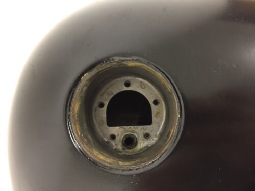

Pictures from eBay... so everyone can see some of the differences with this style vs. others. Noteworthy: The left side fuel gauge hole is larger than the right side, threaded opening for the screw in fuel cap and there's a tube welded through the tank to provide power to the fuel gauge from under the tank as well as 5 mounting screws for the fuel gauge float arm that sits under the actual gauge. The last pic has a different style mount for the petcock (female vs. male) but that could be dealt with. Sorry if I'm rambling. I just wanted to explain my situation and get all the relevant details out there. TIA!

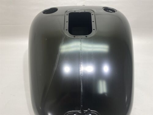

So, this tank is listed as a 2001 Heritage/Fatboy and has that large console hole in the center. I am completely unfamiliar with this tank design and have no idea what additional parts this tank requires. If it will fit on my 2000 Heritage frame, that's awesome but can anyone tell me more about the center dash-hole situation with this model? Does this use a different fuel float (taking advantage of the gaping dash-hole) or the same as the previous model? That listing on eBay doesn't show the left side fuel gauge mounting hole directly, but it does appear to have a similar hole for the fuel gauge power line on the underside, as well as the female vs. my male petcock fitting. This is NOT an exact fit but I am obviously interested in replacements. I just need to know more about the dash-hole and what other parts are involved and needed, in my case. I have to assume if that listing is correct, then the frame fitment should be similar, as I'm pretty sure there were no major frame changes from '00 to '01.

The big square hole in the top is for fuel pump service on injected models.

The '00-'03 Heritage softails use the same fuel tank #62180-00D for carb models. It has the sending unit that goes into the tank, through the left side fuel cap hole.
I replaced that sending unit on my 2001 Springer w/carb. It is a self contained sending unit/gauge. The sending unit sends its signals back to the gauge. The gauge only connects to the main harness via the wires that go through the tank and connect under the left side of the tank. That is for power only (#23 in pic below).

If you are confident and handy working with metal.... You might be able to use a fuel injected Heritage tank #61625-01E (still available new, but very expensive), and modify the left side hole by drilling/tapping it for the one piece sending unit to fit. But then you would have to find a separate top plate to seal the center section. This would be a very expensive option, if you didn't drill/tap properly.
