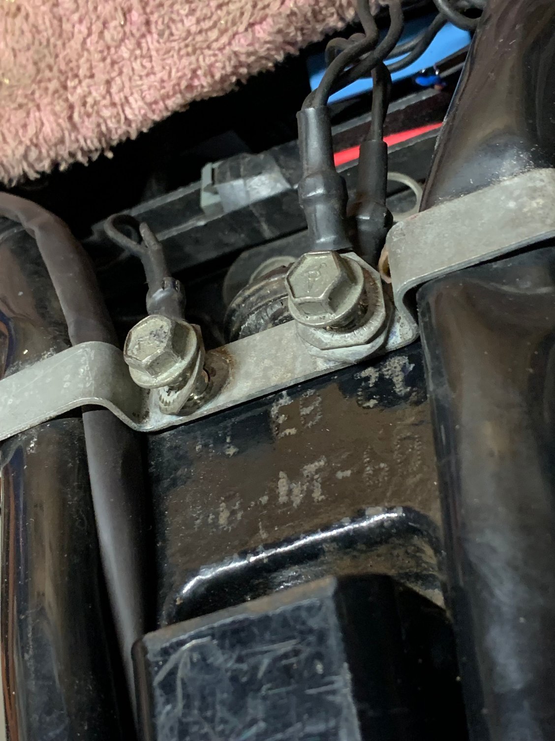

I started by removing the seat and addressing new areas for the grounds. I drilled the connectors just a tad bigger and re-installed them down on the bolts for the oil can. The battery ground I put on the bolt that comes directly out the back of this section of frame so it would have a solid path to the frame.

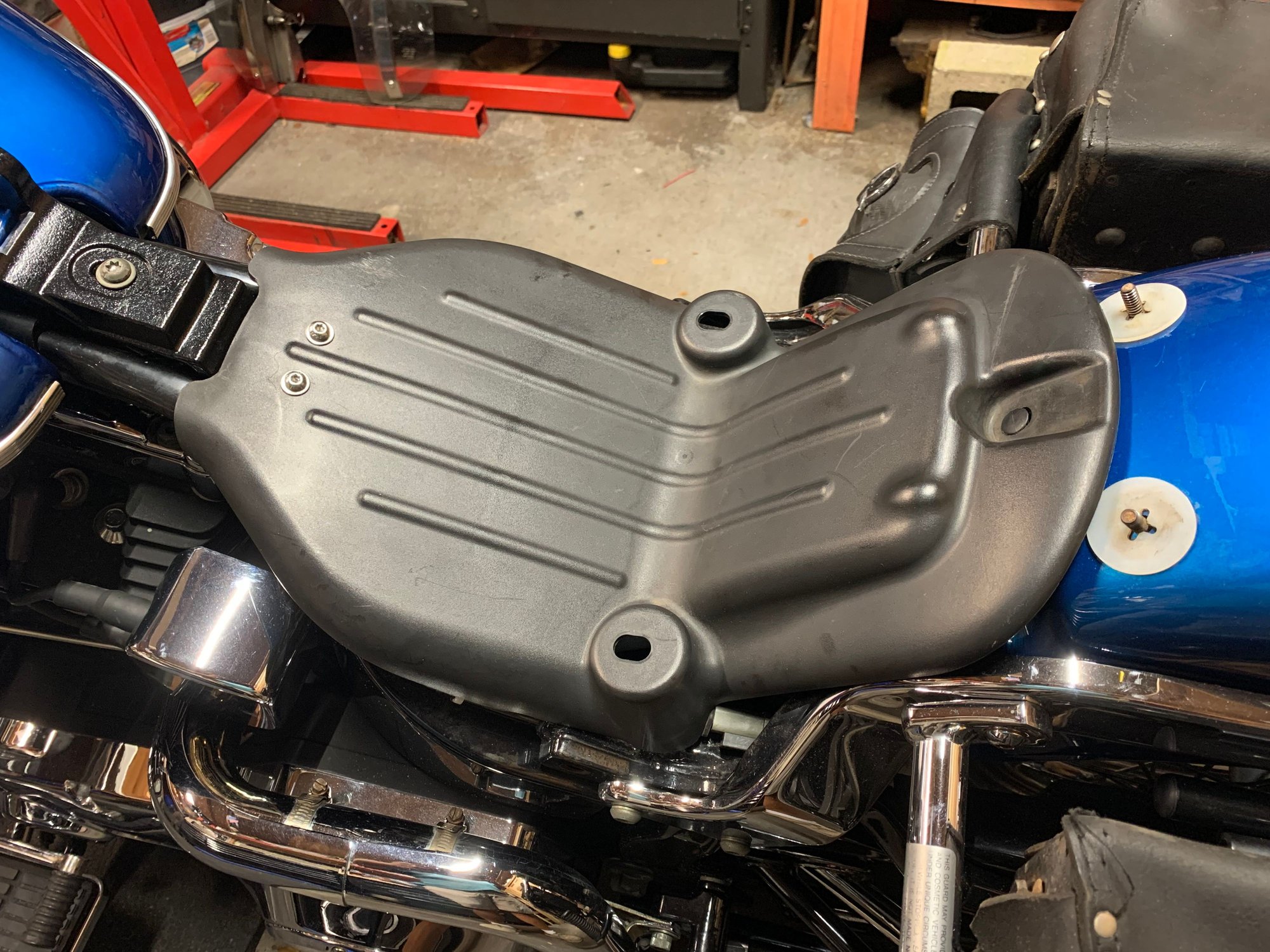

I needed to do a little trimming of the front tang and sand down the underside so it would sit flat.
I started by drilling two holes to hold the front in place. Then I found where I needed to make the hole for the "pogo" to stick through.

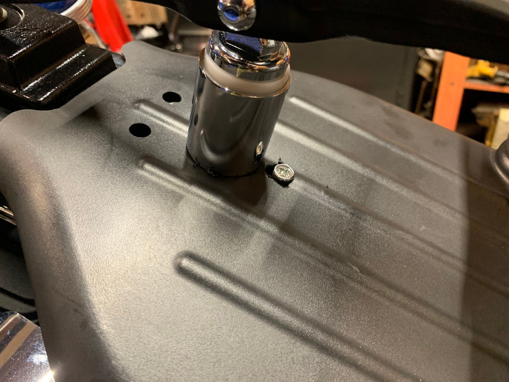

The chrome part of the pogo unscrews from the small mount that bolts to the forward mount to the tank. There are three small bolts, but only two screw into the lower mount, the third screws down to provide the proper angle to the pogo so that it fits in the "T-bar". Not sure why it is designed like this, perhaps to allow for variations. I don't know, it's not like the distance from the front mount bolt is going to change.
The head for the third bolt protrudes just behind the pogo. This will allow me to adjust the angle with everything installed. I might use a black cap screw to help it hide when not needed.
With the T-bar installed, you can get an idea of how it will all look. I'm waiting for the seat to show up. I need to do a little trimming and perhaps heating of the seat pan so it lays closer to the fender. It's not terrible, but a little heat can do wonders.

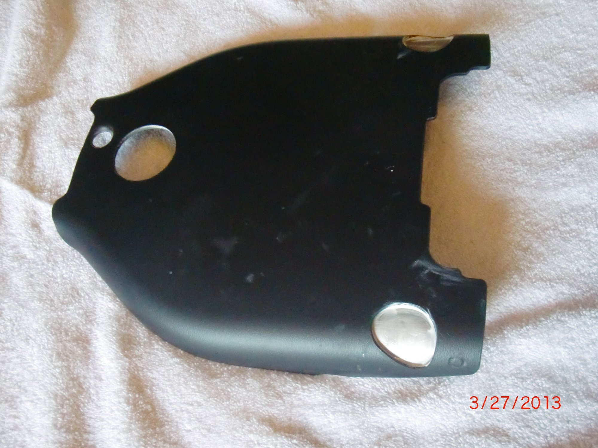

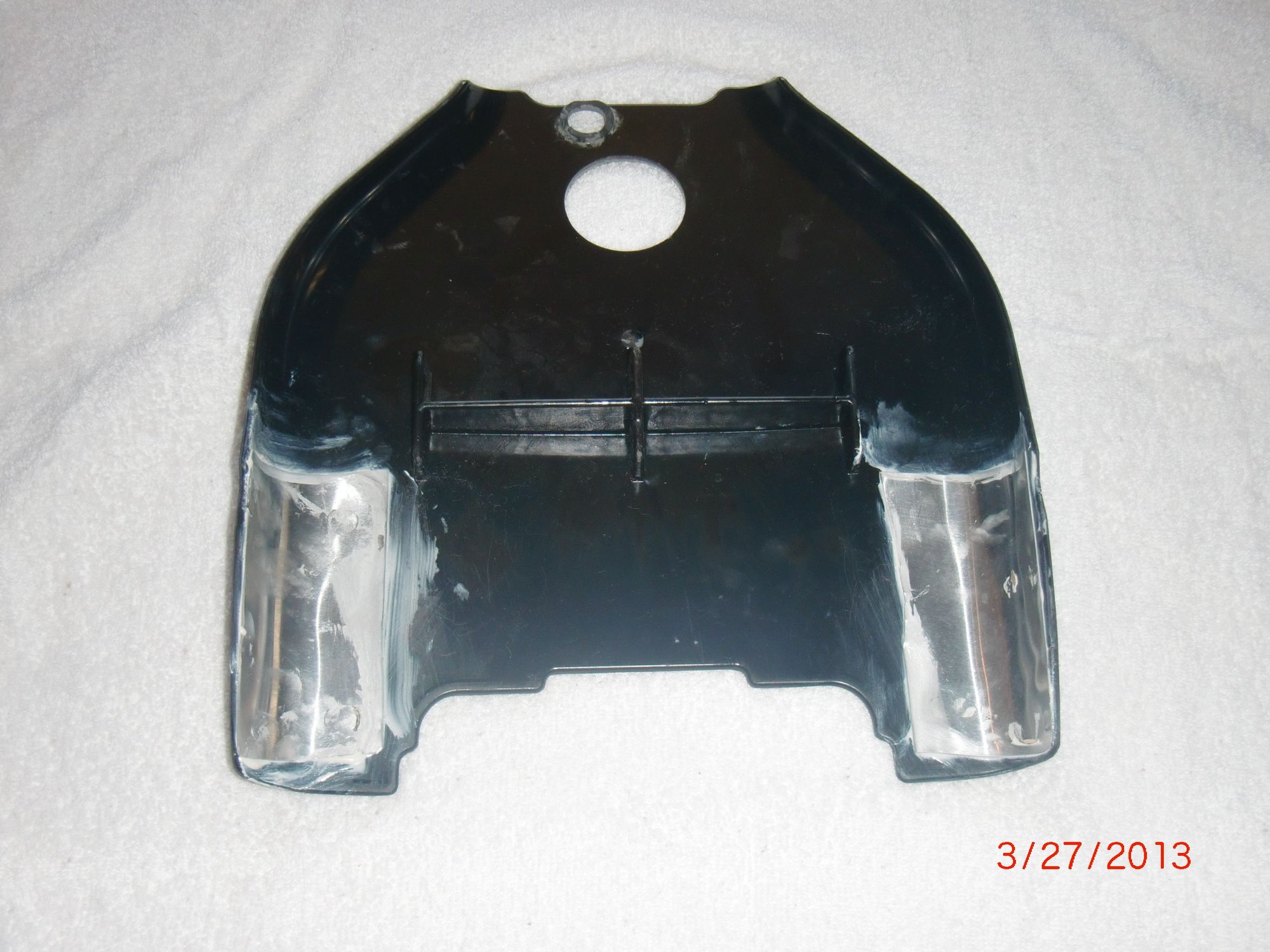

I did this back in '12-13. Here are some pictures that might help inspire you. I started
with the 'solo seat' frame covers and customized them by filling in the holes, drilled a new hole
for the pogo mount, and had them covered with waterproof fabric used for SeaDoo seats:

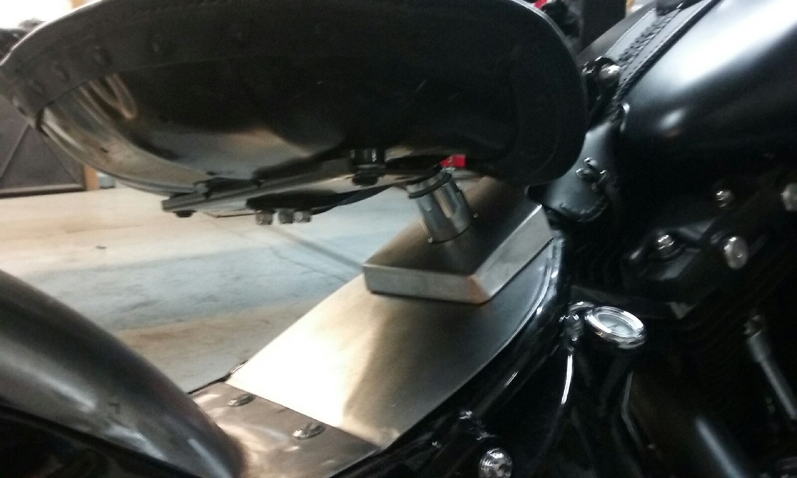

So after I got tired of hearing "it would look cool with a flat pan" from everyone, I switched to an
EarthX lithium battery and a buddy of mine built a flat pan cover and filled in the fender where
ther ECM usually sits. I relocated the ECM down the the BCM compartment....

So, where did you mount the grounds? I initially had them all going to the top of the oil can. But the battery didn't have a good enough ground, so I moved it to the bolt that comes out of the rear of the frame in that area. It has a rubber grommet, but the bolt goes right into the frame so it has a direct ground to the frame this way. The other grounds are still on the oil tank but seem to be working fine. Thoughts?
