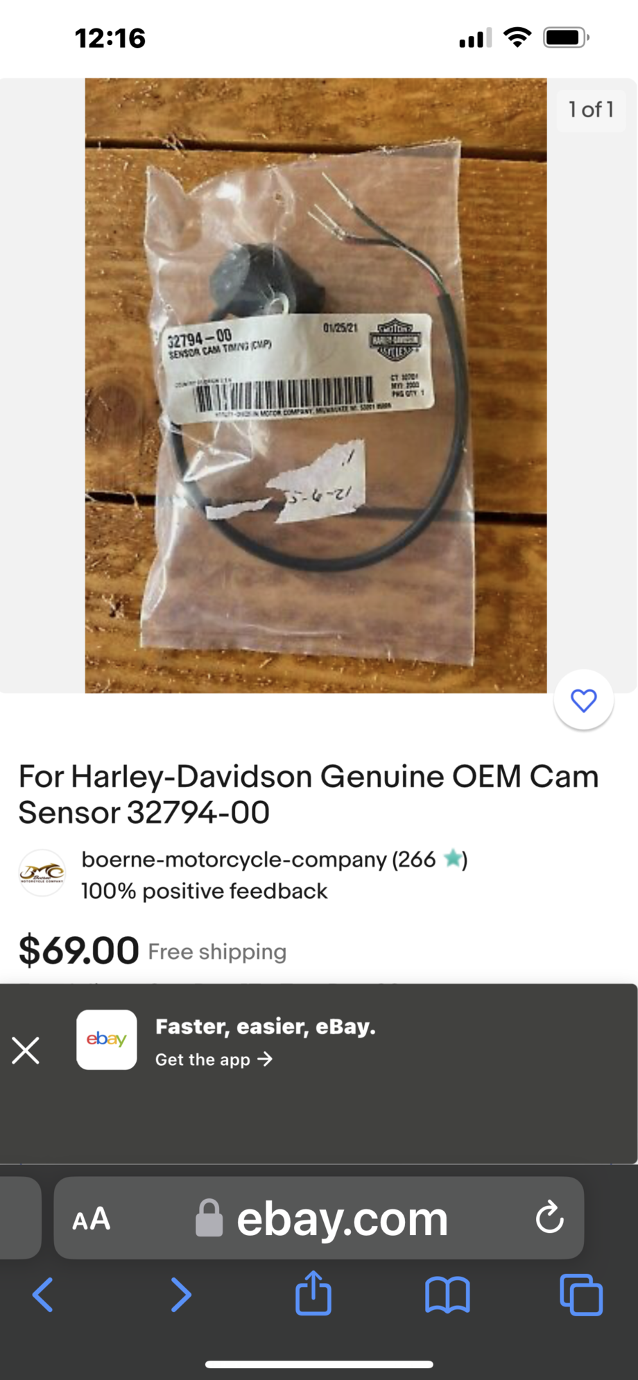

Decided to look around to find a cam position sensor to change just because it is as old as the crank sensor and may be next to go. Another reason is the sensors on the 2000 Softail was a one year part number, nothing before or after fits and was told it will be discontinued by HD soon. Found a new in package OEM HD cam sensor from a motorcycle shop on ebay for 69.00. It is on the way!
