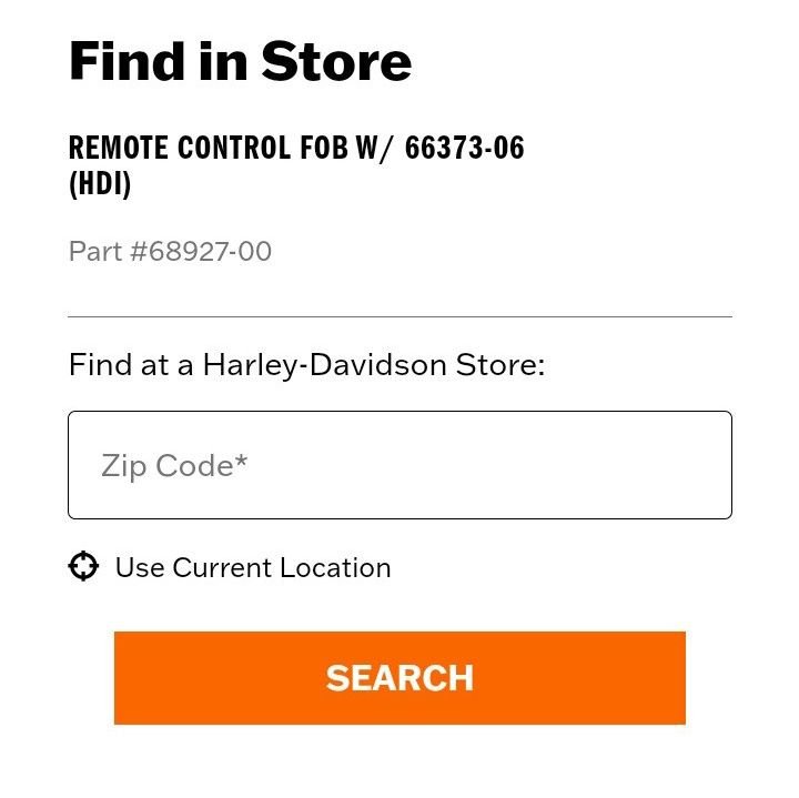

Why are you wasting your time with Ronnie's? You're in Texas, Ronnie's is in Massachusetts. Due to recent HD policy, dealers aren't allowed to ship parts outside of their immediate region.
Go to the link in post #21, select the part # and purchase options.
It will show not available for online purchase.
Select find at dealer. Enter your Zip code.

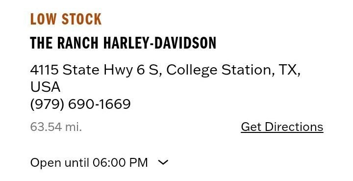

It will show the ten nearest dealers to your Zip code. If any show low stock, it's likely they have one in inventory. Make the call.
