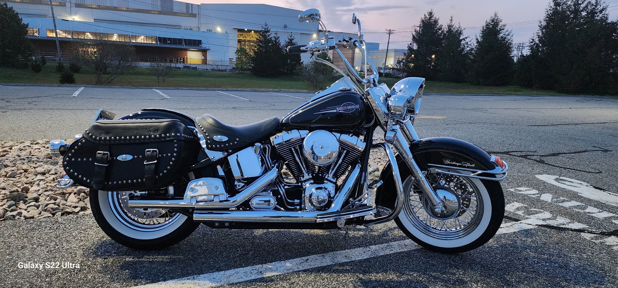

I have an 05 TC88 with V&H Straightshots. Running Stage II https://www.feulingparts.com/sku/7220 Arlen Ness Big Sucker, topped off with a DynoJet PCV. I love the look and sound. After all the work was done I scheduled a tuned. The performance was night and day, the tuner told me I'd get more out of the 2into1 down low, but it just wasn't the look I was going for. I wasn't building a race bike, just something that'll pull a lil harder down low when loaded and 2UP. She get's it done, I'm not a big guy and the GF is a peanut. I'm 100%+ pleased with the performance, but I'm always looking for a lil more.
