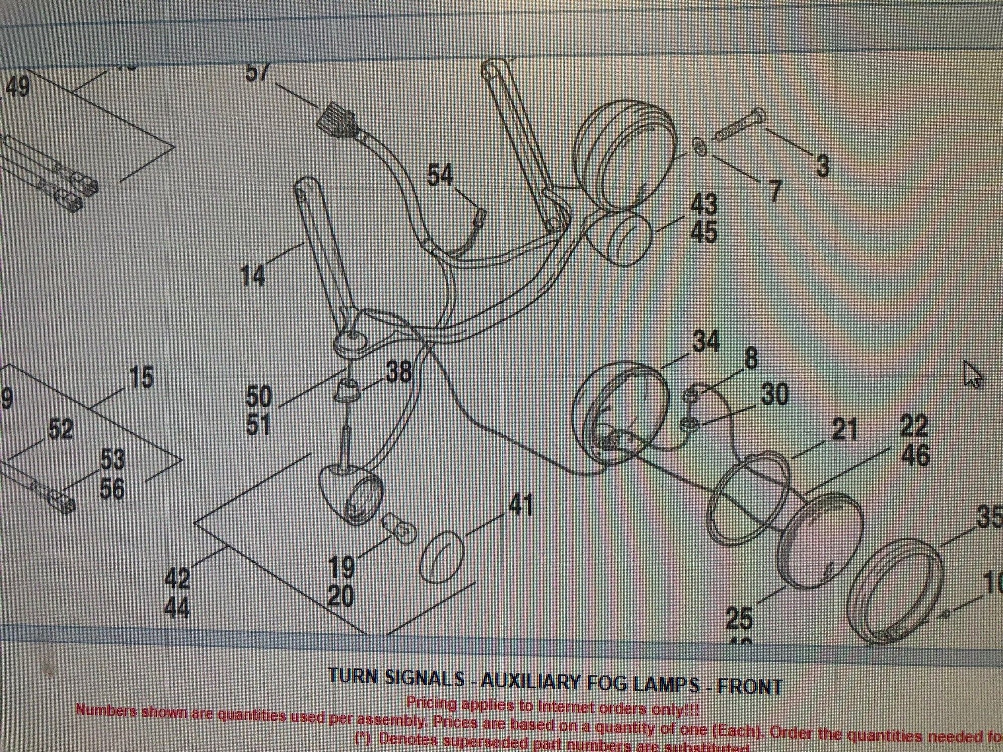

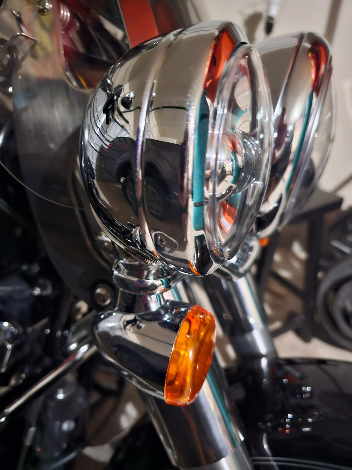

I replaced my headlight and auxiliary/passing lights with LED's. I was able to adjust the headlight but cannot adjust the passing lights. The passing/turn signal assembly is different than what the videos shows on how to adjust them. I cannot disconnect my front turn signal assembly lights from my passing lights so I can adjust my passing lights with the 9/16 socket that I hear everyone talking about in their videos going through the turn signal light. Anyone have any idea how or why this 2016 softail deluxe is different?

Take the bulb out and loosen #8
