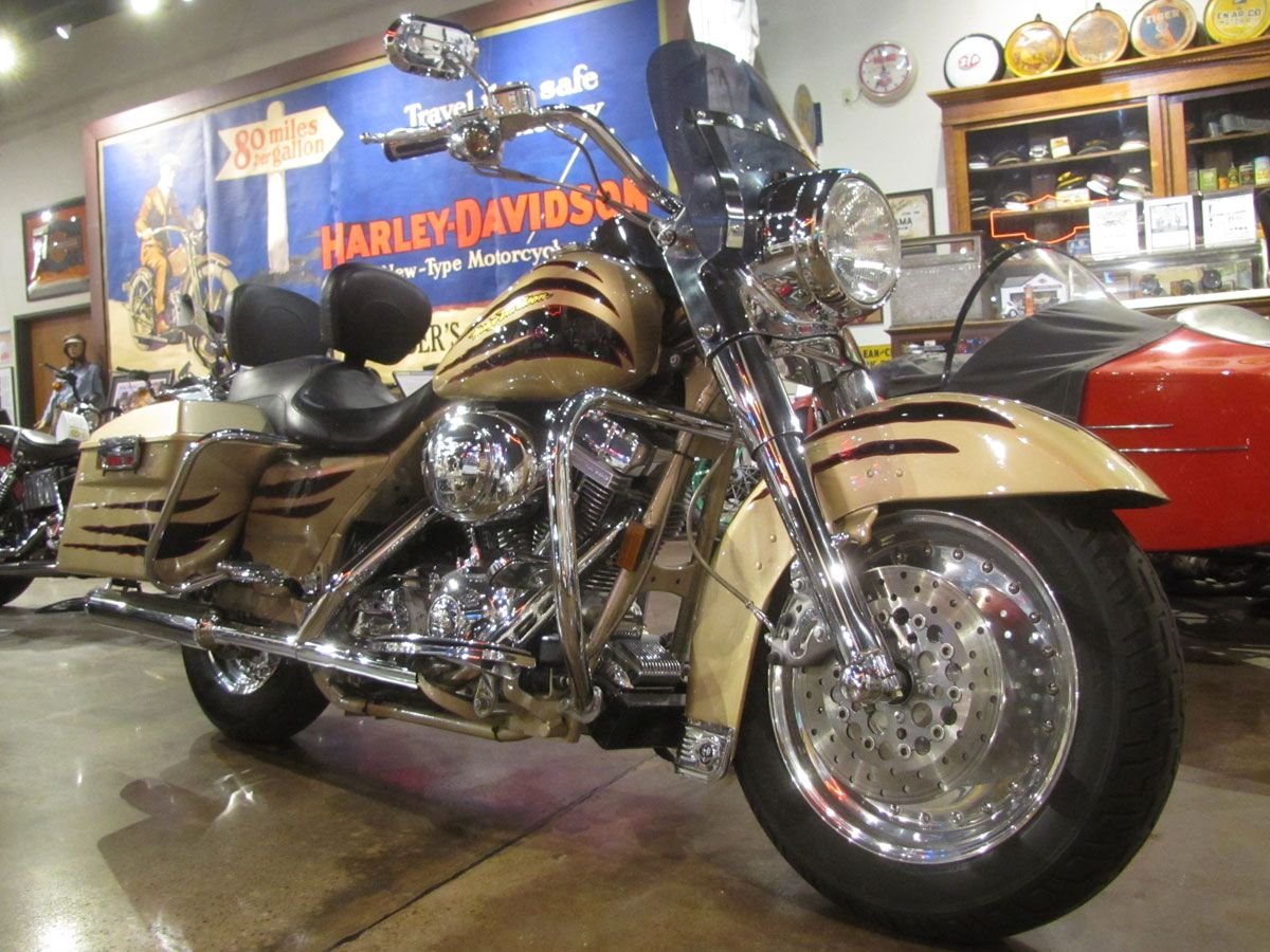

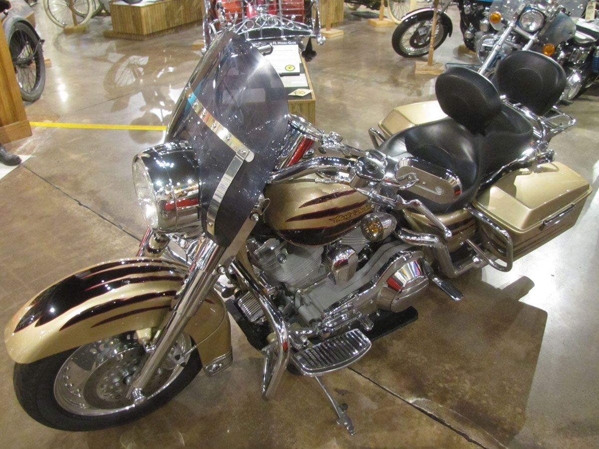

Hi guys, I recently acquired a 2003 CVO Road King (My first Harley) and need some advice on Passing Lights and Turn Signal Lights. This Model has the Trun Signal Lights mounted on the Handlebars and does not have any addittional passing lights. I would very much like to add some passing lights similar to those found on the non-CVO models of that year, which includes turn signal lights just under the main headlight. I would like to keep the handlebar mounted signal lights and have them work in tandem with the addional ones on the lights bar. I am also thinking of "upgrading" to some LED lights. How difficult a task would this be? What additional parts/hardware would I need? Could this be a DIY project?
Thanks!!
Here are some stock photos of the same model just to show the lights locations.
I assume I will have to find a lights bar like this to fit on my model:
Ultimately, I would like it to look like this:

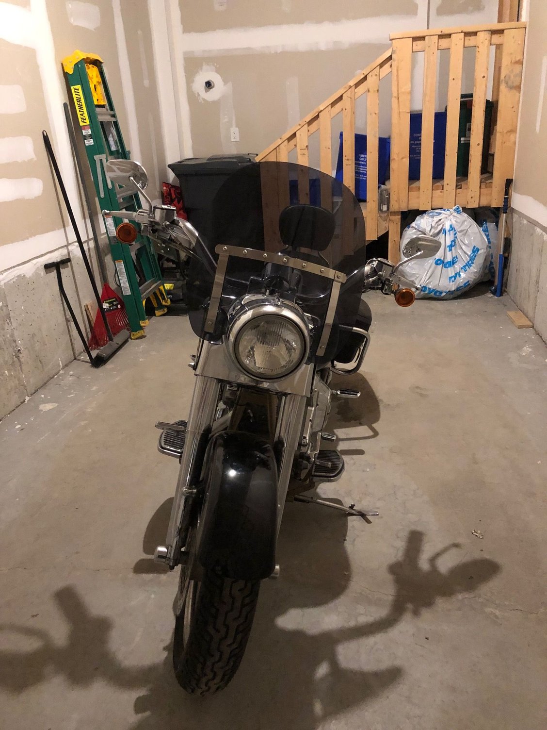

So, I have added the Passing Lights, Fork-Mounted Wind Deflectors and Engine Guard (among other things). Here are before and after pictures.
I much prefer the "after" look. My next step is to upgrade the lights to LEDs. On that front, I have two options:
(1) Insert some Morimoto 2stroke 3.0 LED Bulbs in the existing housings of both the Headlight and the Passing Lights: https://www.morimotohid.com/morimoto...lbs?quantity=1
(2) Install this Eagle Lights Kit: https://www.eaglelights.com/products...9f592048&_ss=r
The prices for the Bare Bulbs and the Eagle Lights Kit are about the same (I will need three bulbs). What do you guys think about these options? In terms of looks, the Eagle Lights win every time, but I was wondering which option would be more effective in terms of real-world performance???.
In addition to the above, I would like to retain all four signal lights; the two mounted on the Handle Bar as well as the two attached to the Passlng Lights bar. Is it possible to have two pairs of active signal lights? I would appreciate any suggestions or comments.
Regard,
Rick
PS: Those passing lights and signal lights have not been hooked up as yet, hence the odd looking black wire around and between the fork.
