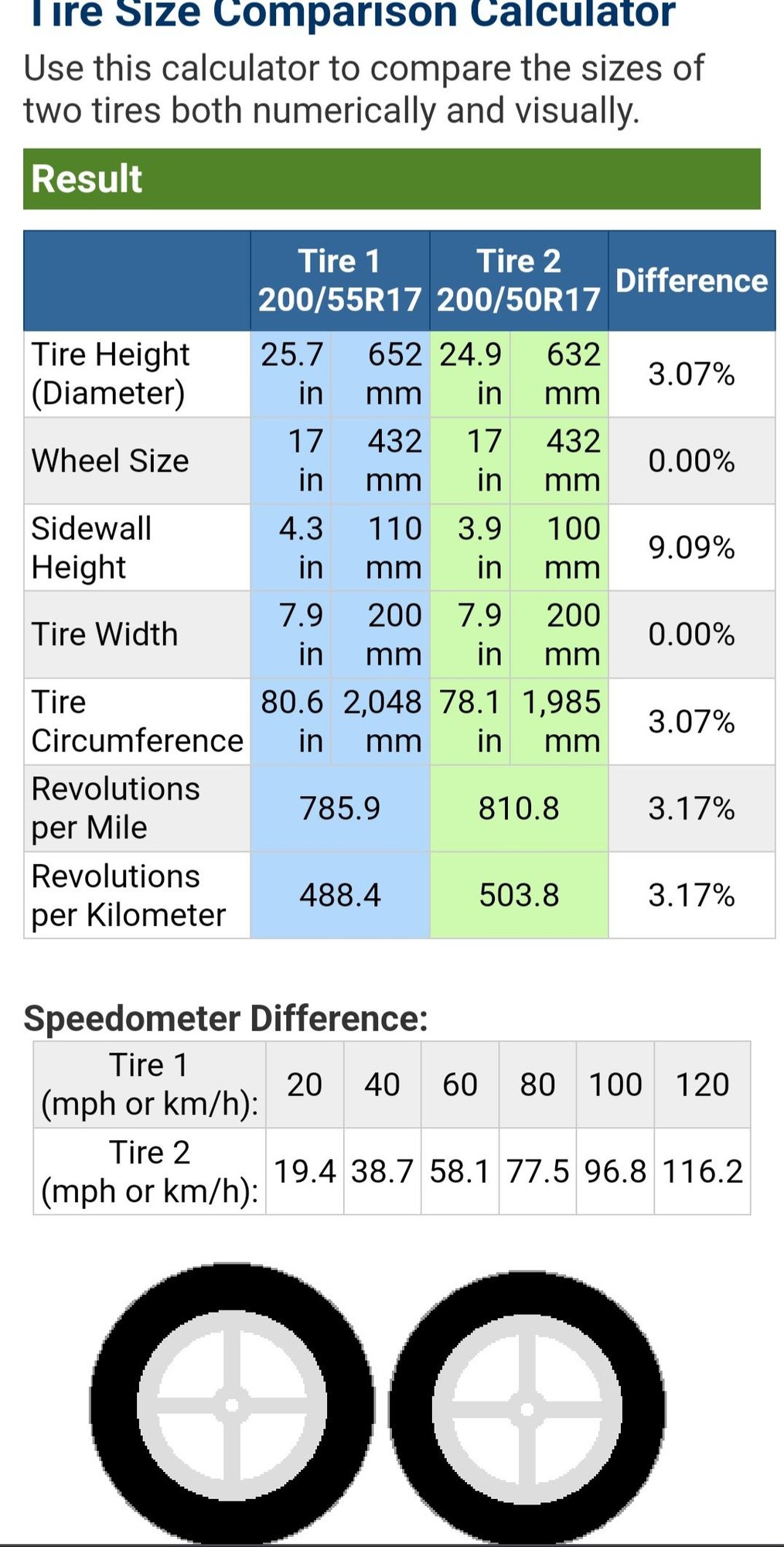

Hi
I'm about to change tires on my 2014 fatboy lo and found some tires with a lower aspect ratio,will they work without any issues?
only thing i understand is that contact patch will increase.
anyone running lower aspect ratio tires??

I don’t see why not. Engine rpm’s will be higher and ride will be harsher as side wall is smaller. But acceleration will be better…..
