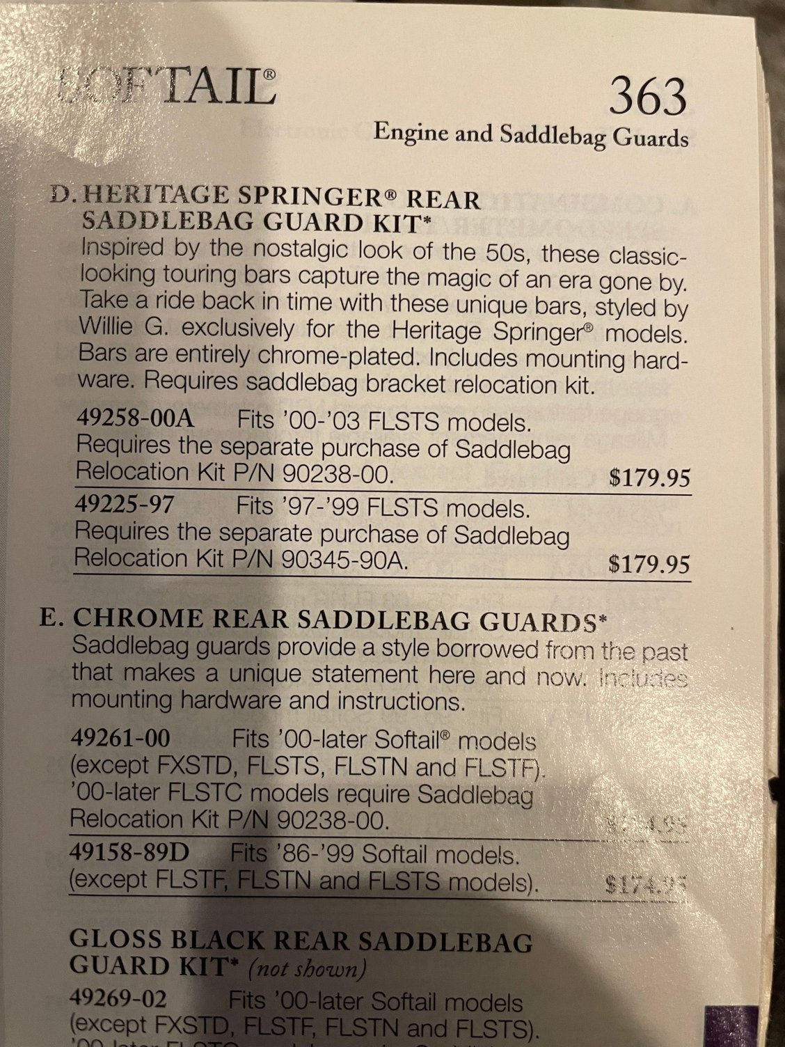

2005 accessories catalog

Thanks for the info, I'm going to try the FLSTC ones. Found a set on e-Bay for a decent price so if I have to make some custom brackets no problem.

Just a follow up post.....I received the FLSTCI saddlebag bars today (quick shipping) and they looked great, and installed easily after I purchased two different bolts than what was provided (I have HD passenger floorboards installed which used up the extra length on those bolts). The left side was a tad difficult to get the bolts started but not horrible. The saddlebags are not as easy to install/remove as they were but I don't remove them often now that I don't have white walls to clean. Once again, thanks to all for the help.
