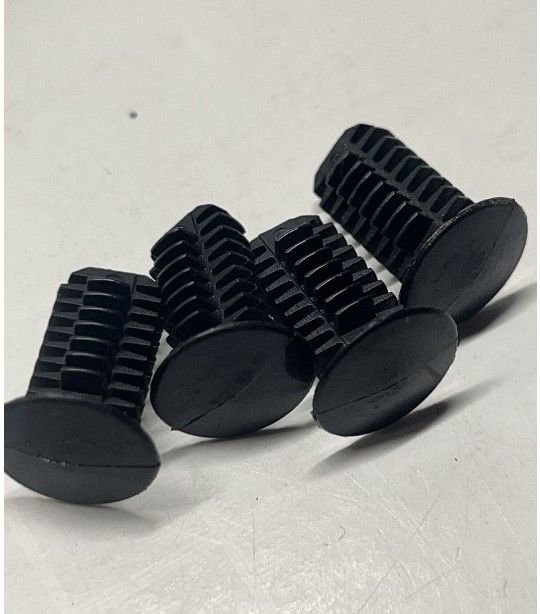

I have an aftermarket engine guard on order for my 2023 Breakout 117. It mounts the exact same way as the OEM engine guard: Top bolt into existing hole in the frame just behind the headlight, and one bolt each into left and right side bottom front corner of the frame.
I THINK the 2 lowermount points on each side are where the "removable" threaded insert is currently located on each side. I THINK the right side threaded insert is shown at about the exact centre of the photo below (the dark colored bolt head with very thin line across its diameter,below the white torn-off label):
The "slot" in the head of that threaded insert is way too narrow to accept a conventional screwdriver. What is the PROPER way to unthread and remove that insert?

What does that go to.....?
I could not find that fastener on the online parts finder. It looks like for your year/model there should be an x-mas tree clip (plug) in that hole on the frame... but I'm not sure
That certainly isn't an x-mas tree clip (plug)... Sorry, I'm at a loss...

The X-mas tree clip has a line across the head like the OP's pic.
Technically, it doesn't thread in or out. It's pushed in. If the backside is accessible, take a small diameter wooden dowel and tap it out with a hammer. The dowel won't mess up the threads in the frame.
Those things are a bitch to get out! The new ones, 18+ are really stiff plastic.

Ok, so it sounds like those "threads" on the "plug" are not actually threads, but rather just "ridges" to help keep the plug in place. It sounds like using a wood dowel to pop them out makes sense, IF (BIG "if") I can get sufficient straight access to the inner end of each plug. IF I canNOT, then to avoid damaging the frame paint in trying to PRY them out, I guess I could try fitting the tip of a typical dining knife into the slot and trying to "unscrew it". If that fails, then put some masking tape on the frame and use the dining knife tip to pry the plug out?
If I owned a wine cork, I could possibly screw the wine cork remover into the plug and yank it like I would a wine cork, being careful to not tip the bike in doing so. But, I don't own a wine cork remover.

I've also heard/read that some will drill a small pilot hole in the plug. Then insert a self tapping screw into the pilot hole. Grab the self tapping screw head with needle nose vice grips, and rock it up down, side to side to work it out.
That sounds like a workable way to do it. Thank-you!

When I first looked at the pic, I was sure that wasn't made of plastic and couldn't be a x-mas tree clip (plug)...
However, now that I zoom into it... I believe it could be a X-Mas Tree Clip (plug) from the parts diagram...
If it is in fact a plastic piece, you've been given good suggestions on how to remove it...
