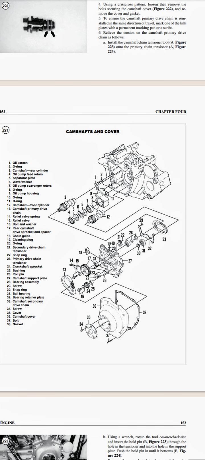

Originally Posted by Shaggy520
This is how my tank looks
Originally Posted by RANGER73
The check valve (ball valve) in the oil pump is stuck open.
It's under 1 of the caps/plugs on top of the oil pump, the 1 over the oil line from the oil tank.
Probably gummed up. Clean it and reseat it. Might be time for a new spring too.
Can you please point out what your explaining.

In your diagram, you will need to inspect #4,5,6,7,& 8.... something is wrong with the fitment of these parts, if they are not broken, if your oil tank is draining that fast at shut-off. I suspect you will find a major problem with #4, or maybe something worse... sorry to report that to you.
Bottom line is the oil pump is scavenging oil back to the tank, not making pressure, and draining quickly when the engine is shut down... There is a serious issue with your pump. I will again caution you, do NOT start the engine until you find this problem.
Ranger was referencing #7 in the pic below. It is on an EVO and Shovelhead oil pump... sadly, the Twin cams did not retain a check valve feature in its design to stop backflow form the tank to the sump. That job was relegated to the gerotors in the oil pump housing. Their tight fitment is what keeps the oil up in the tank... no check valve.

Ahh I see, that's why I couldn't find it in the manual thank you.
