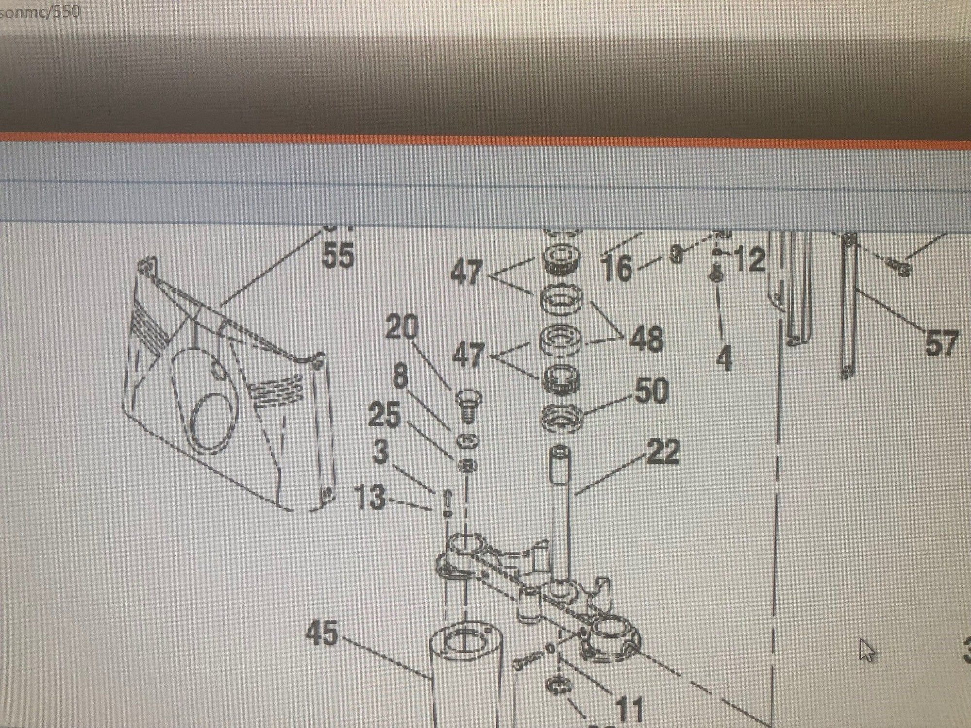

After further inspection. Is it possible to remove the forks by loosing the pinch bolts with out removing the front panel, headlight and aux light bar?
BTW, everything is stock.
THX
Old Apr 22, 2024 | 06:47 AM
eighteight's Avatar
eighteight
Joined: Oct 2019
Posts: 10,776
Likes: 7,403
From: OH
No, you have to have access to item # 20
I`m ASSUMING you have a Heritage because you didn`t mention model !!
