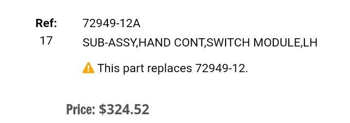

If you purchase a new switch module, make sure you get the updated part number. If you go the eBay route, you might end up with another dud.
