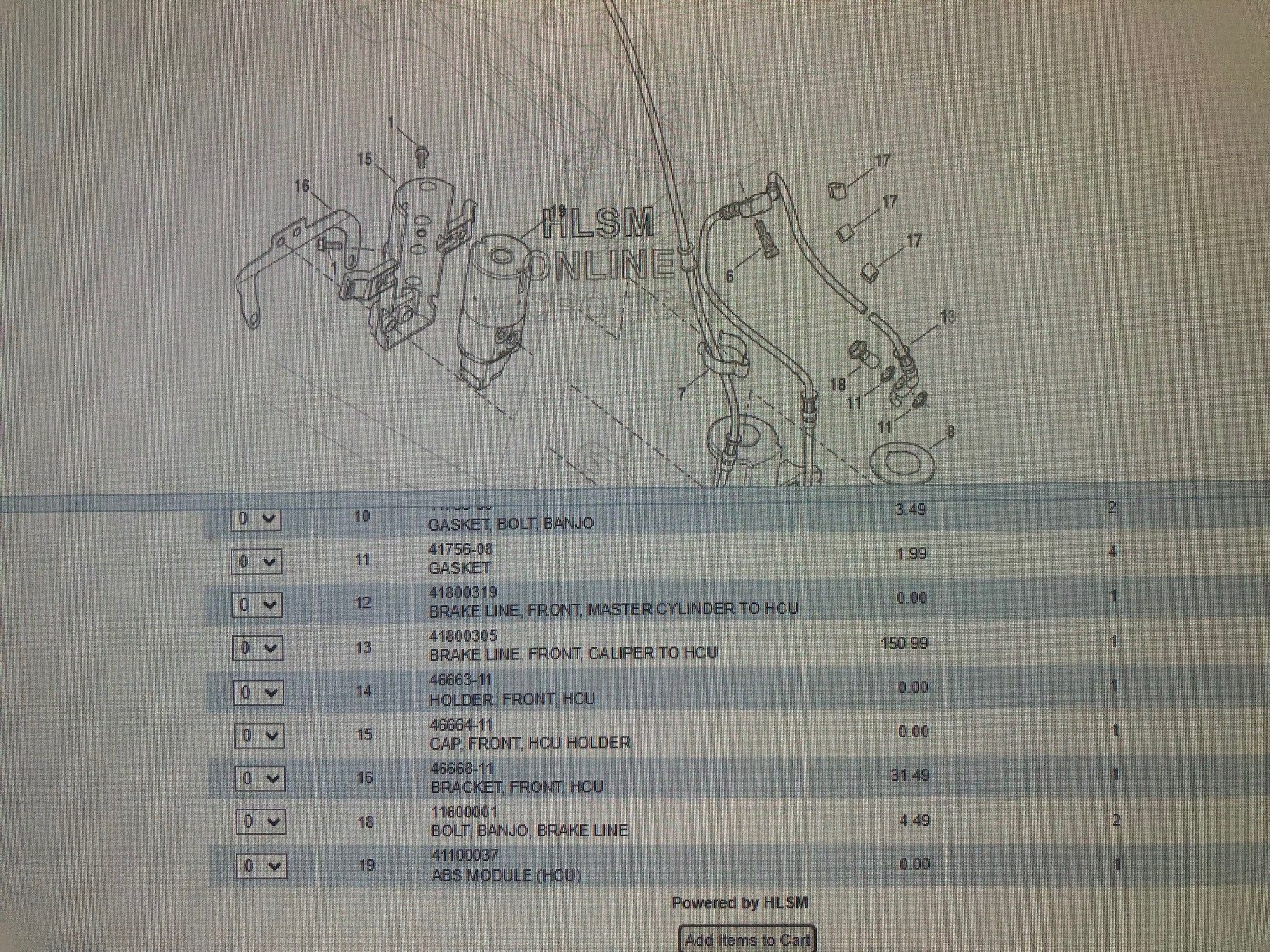

Hi all,
I have a 2016 Fatboy S.
When not riding I can hear a ticker from time to time coming from the front hcu.
I can feel a short vibration on the front hcu when this is happening.
This leads to an empty battery. Sometimes it takes 3 days, sometimes I can leave her for a week and all is good.
Every time the front hcu is doing this the voltage drops from saying 12.7 to 12.4 volts.
The more it happens the more the battery is drained.
Usually I have a trickle charger on the bike.
But I will do some travel with it and make sure it won´t drain my battery on the trips I am planing.
There is no dtc stored.
I also have a 2016 Slim S that is not having this problem at all.
Any idears from you guys?

HCU is the ABS-Module. At least they call it that in the service manual.
And yes, it is a hydraulic control unit.
Sorry if I named it wrong.
