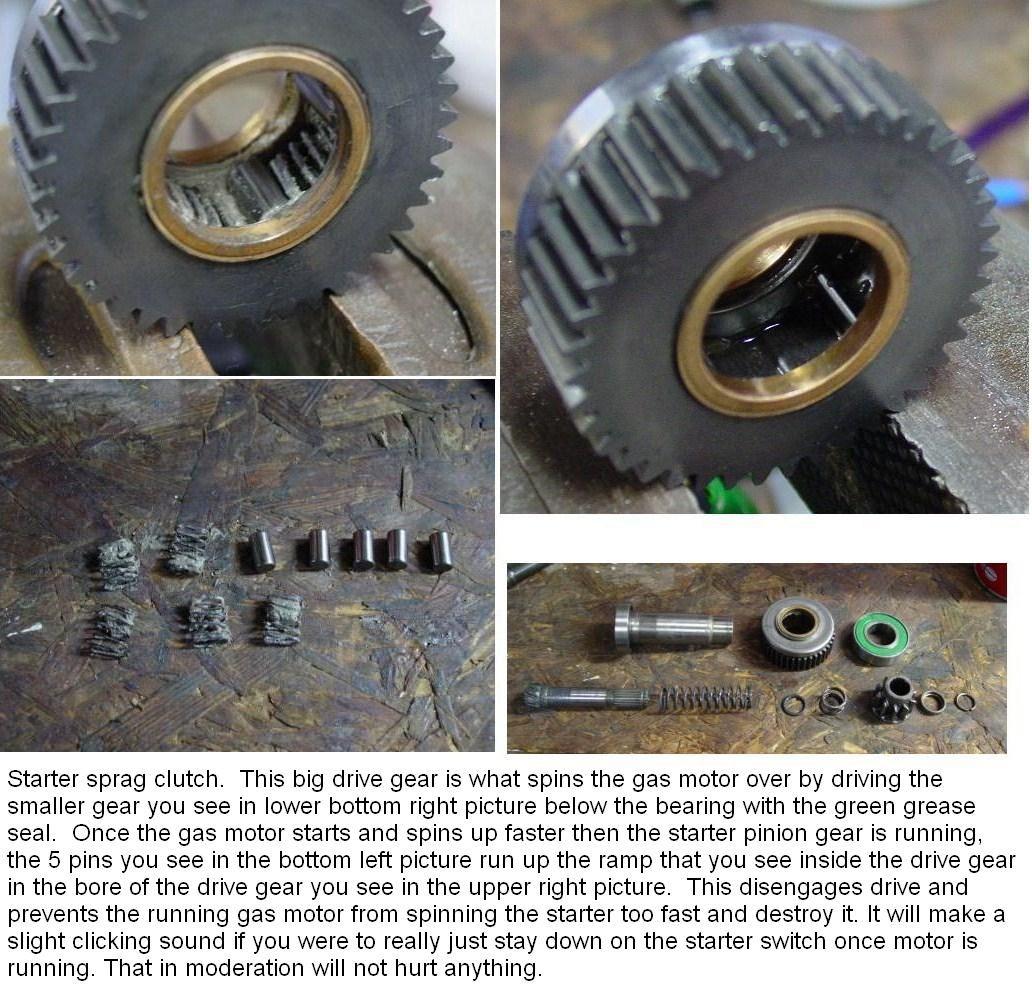

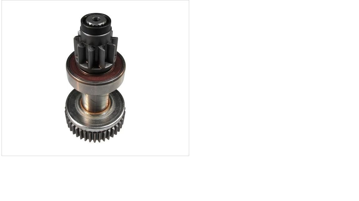

Had my 04 since 06. That's 18 years of batteries. I replaced the original around 2009. It was doing just that. It popped the temperature oil dipstick out twice and blew smoke out of the open SE filter. It banged the compensator terribly. Someone said just what I just said in post 3 and I had the battery checked.
When I learned most heavy CCA checkers at Autoparts stores don't do a good job on these small gel matt batteries. Why I said check that cranking voltage. A sprag clutch rarely wears out. Compensator fingers get rough and drive you crazy at idle on how they sound with Harley's idle but that doesn't cause a bang.
What I said was from experience that you check and correct first. Then fall for the tin man BS or pull and look. And looking involves pulling compensator. If he does what I said, there is a good chance it's going to fix it. If there is an internal mechanical issue, it does it all the time. If the compensator was actually weak, it would bang shifting.
A starter sprag clutch drives with rollers up a ramp. It can't slip. If you hold starter motor in too long, with the gas motor running, the gas motor outruns the starter and the the sprag clutch works like a 10 speed bycycle hub and the clutch free wheels with the drive pins on the bottom of the ramp.
The crunch is a weak battery dropping so low, the solenoid magnet drops out retracting the starter gear and that crunch is the end of the gear hitting the ring gear on the clutch hub.
All from a weak battery probably
