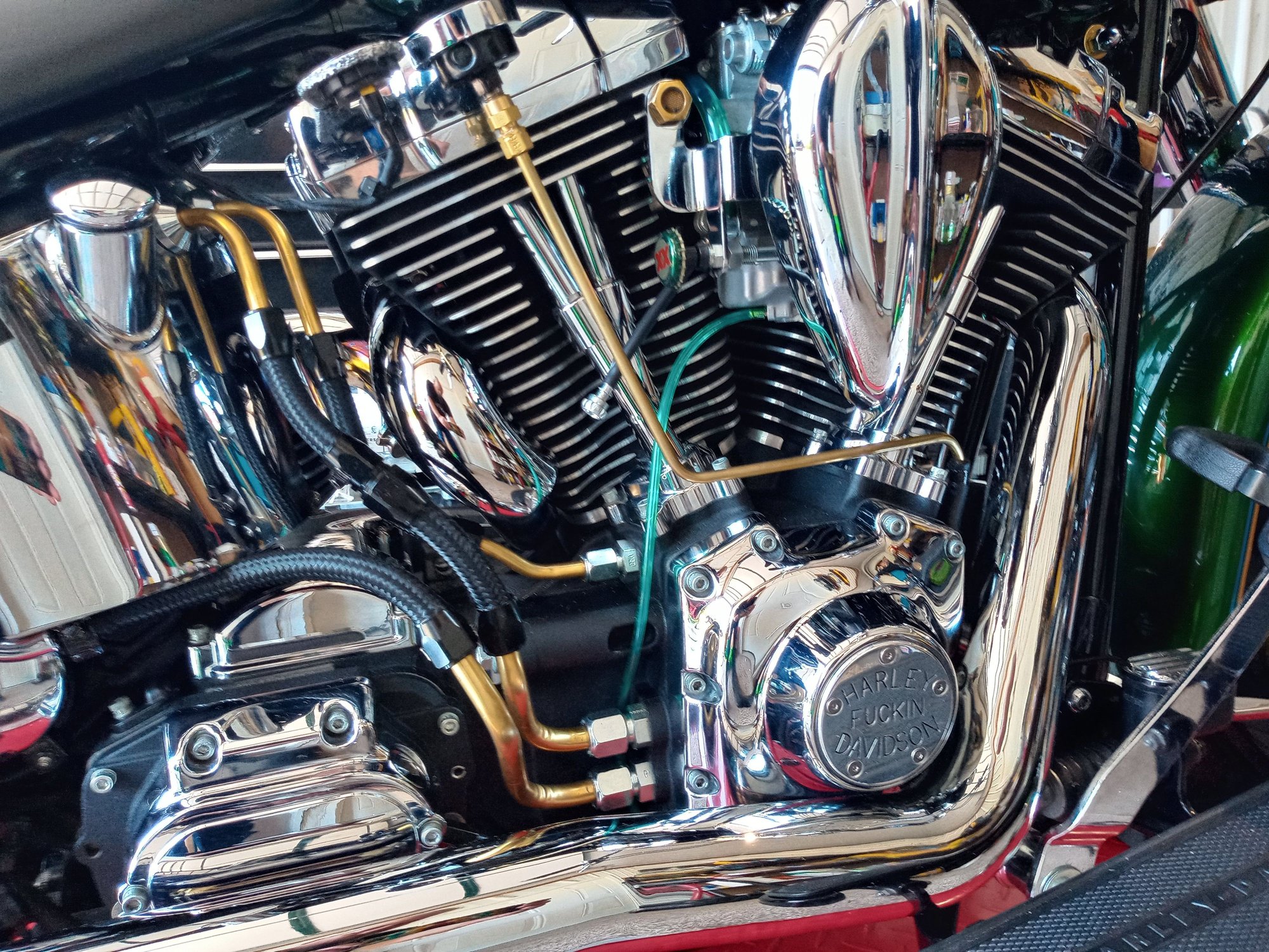

Here is what I did to my oil lines.
Where did you get your ignition cover? Are those copper oil lines?
