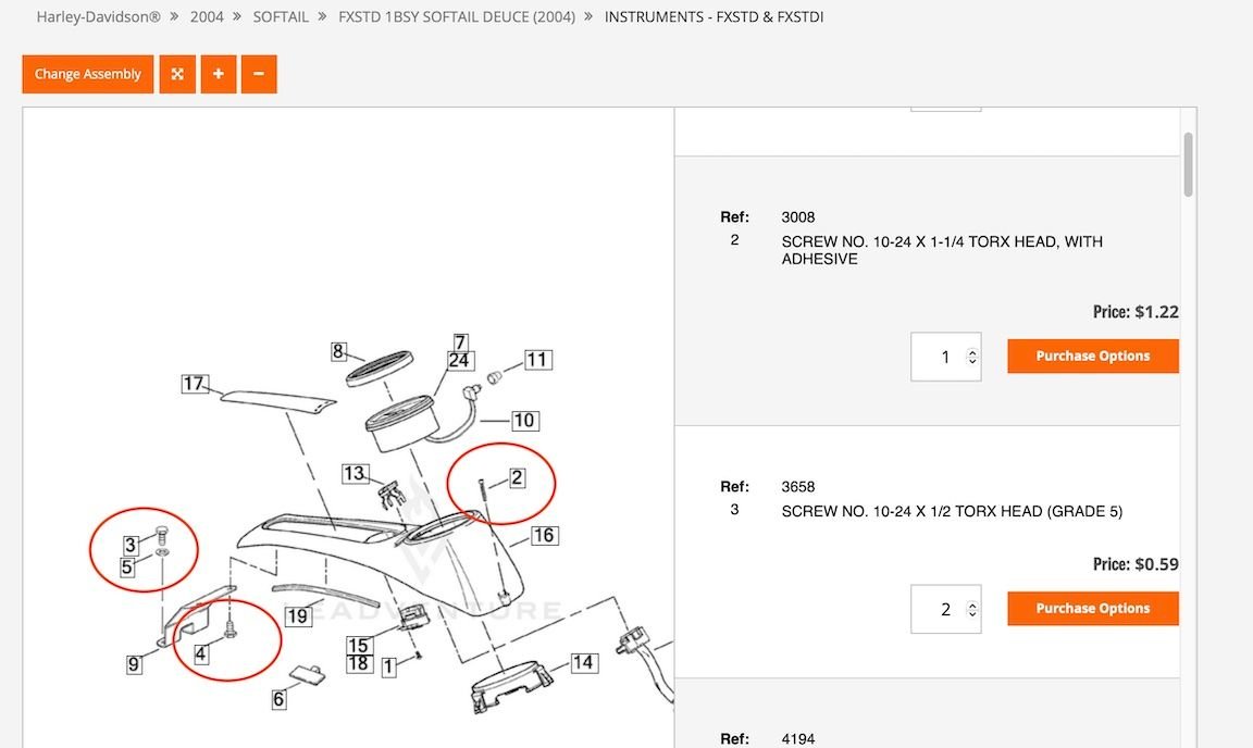

Is it the top screw you are looking for? ie: #2 in the parts pic.
Or one of the four bottom screws? ie: #3 in the parts pic, or #4 in the parts pic.
If you decide to get a replacement at your local hardware store (almost always cheaper than an HD screw/bolt from a dealer), always double check the size. Once in awhile there are misprints and/or mistakes in the parts manuals/sites relative to sizes..
From the website given to you by BFREE.

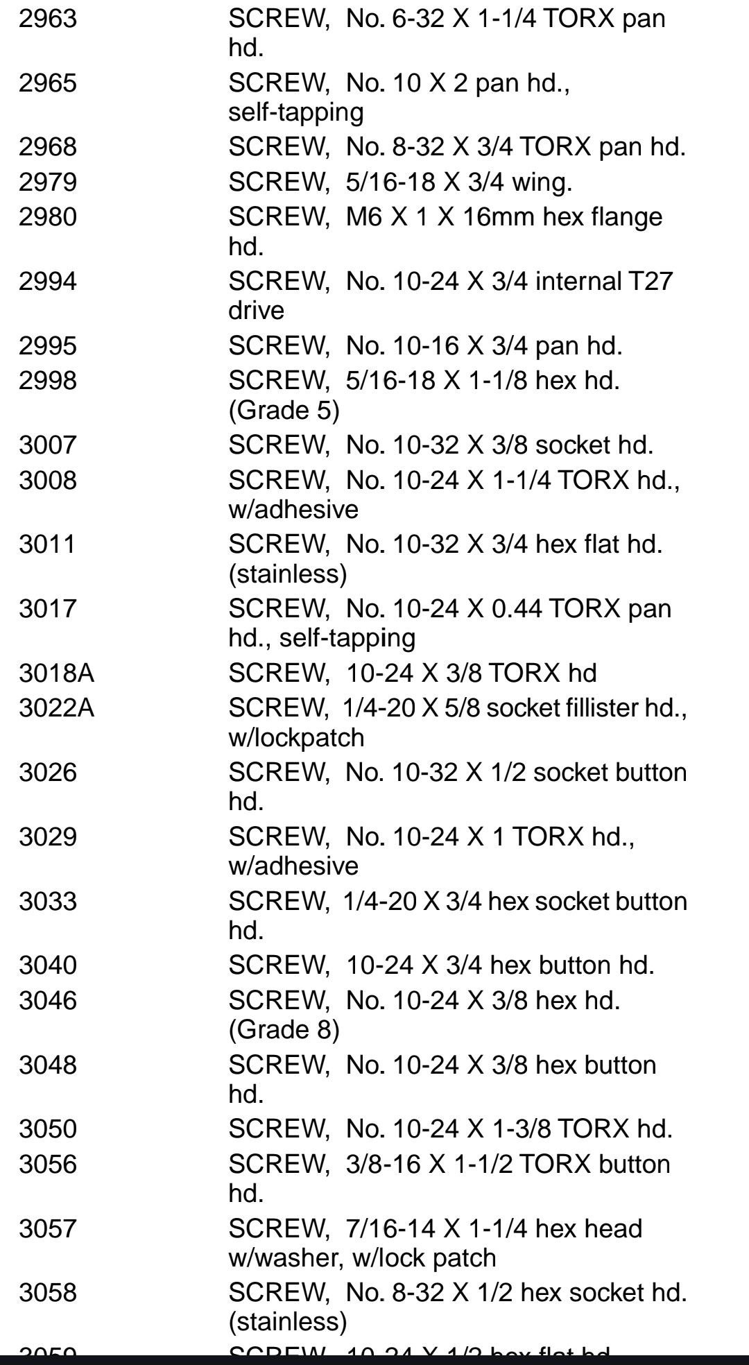

It's probably a Harley item 3008.
https://www.hdforums.com/forum/gener...ion-specs.html
A #10-24 National Coarse threads per inch by 1 1/4"long. Use SS and allen capscrew. What I replaced mine with in an 04 Duece.
It's not metric but English units. #10 is 0.190 diameter or apx 3/16. It's not called 3/16-24 however.
Number screw diameter for are small fastners are identified starting with #. .060 + unlucky 0.013 increments for #0-80 (0.060 diameter) thru 12 and are first fraction size is 1/4.
