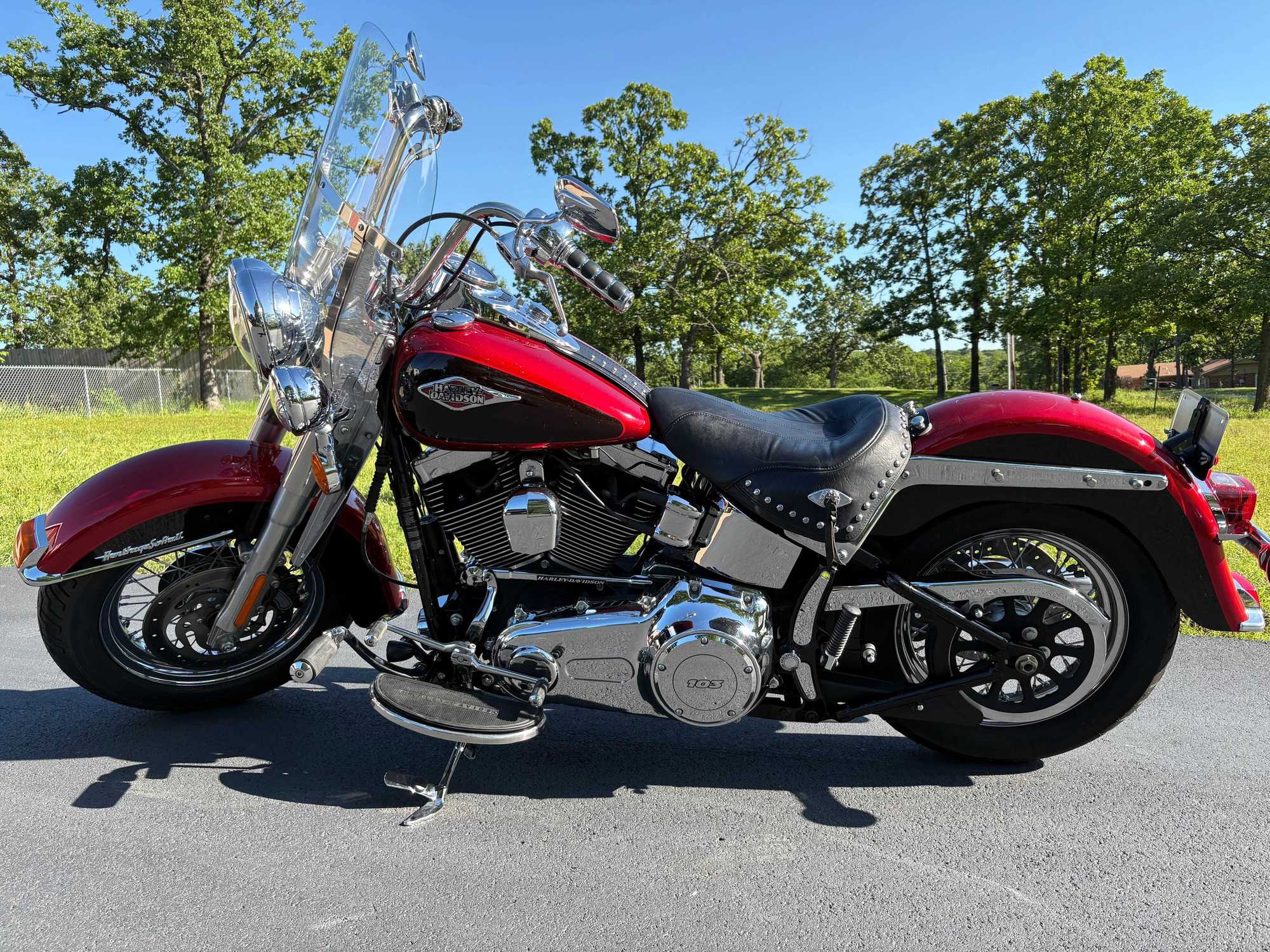

I recently bought a 2012 Heritage Softail Classic with a Twin Cam 103 and have a few things in mind to upgrade and customize it a little. Most of my mechanical experience is with 4-wheel vehicles, so around motorcycles, there are a few areas that I have little or no experience. For that reason, I wanted to start this thread to seek input and advice and document my progress as I go.

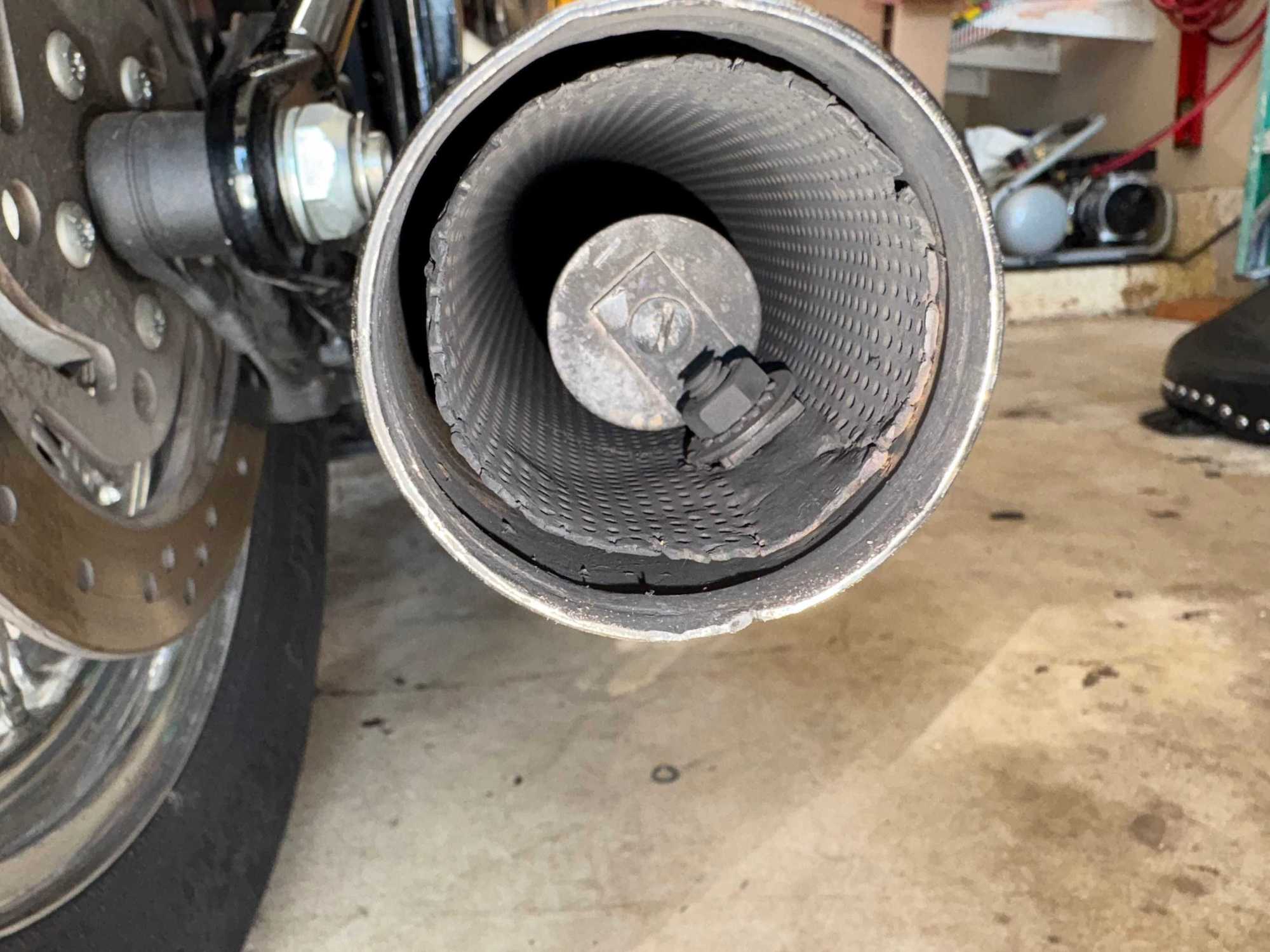

The first thing on the list is performance: The bike currently has an older Screamin' Eagle High Flow Air Cleaner, de-catted stock mufflers, and a Screamin' Eagle Super Tuner Pro tuner. (The tuner appears to be an older version and didn't come with any cables) The de-catted mufflers have some sort of tab installed inside them (see photo below) which I assume is to help increase the backpressure. The mufflers sound OK but have a "hollow" sound that I don't like and I'm getting some decel pop on deceleration and shifting.
