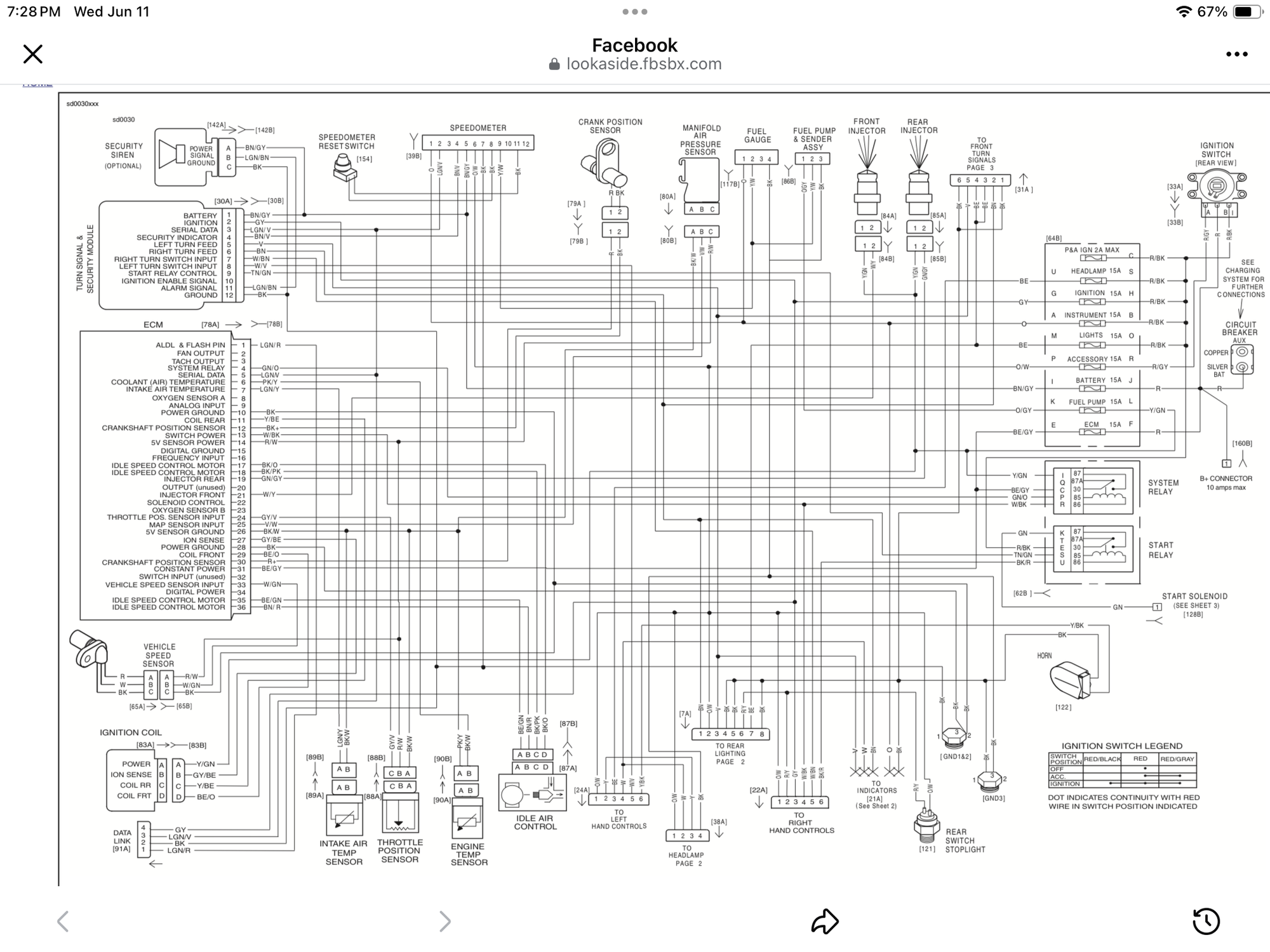

Hi I've been on here a few times.Anyway I have a 2005 night train fuel injected .There's no power at the start button.Ive had to 2 shops neither one got it running,one said it was more then likely the ecm and the other said the tsm. So I decided to bypass the tsm and now the start button works but bike shuts off immediately. If I spray starting fluid in it I can keep the bike running I'm losing the power to the fuel injectors. Any help would be greatly appreciated

If you put the bike back the way it was , TSM connected, turn the ignition on and run/stop switch to run, does the fuel pump run for a few seconds?
