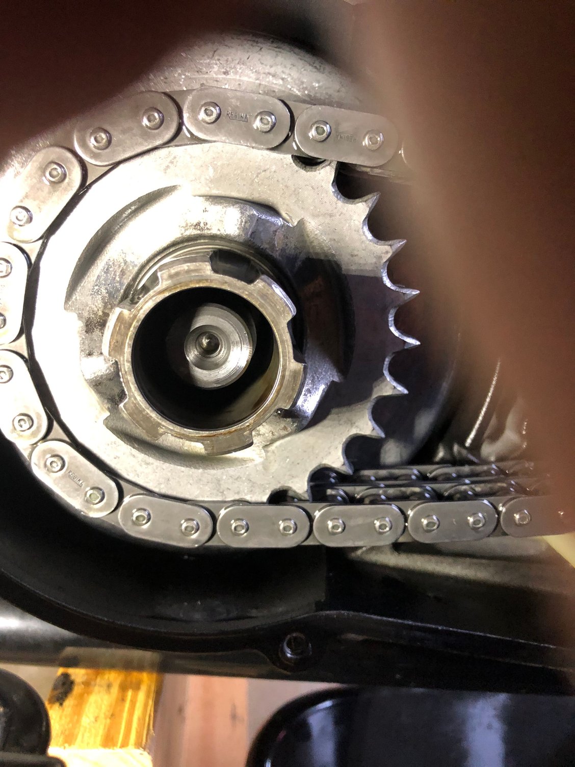

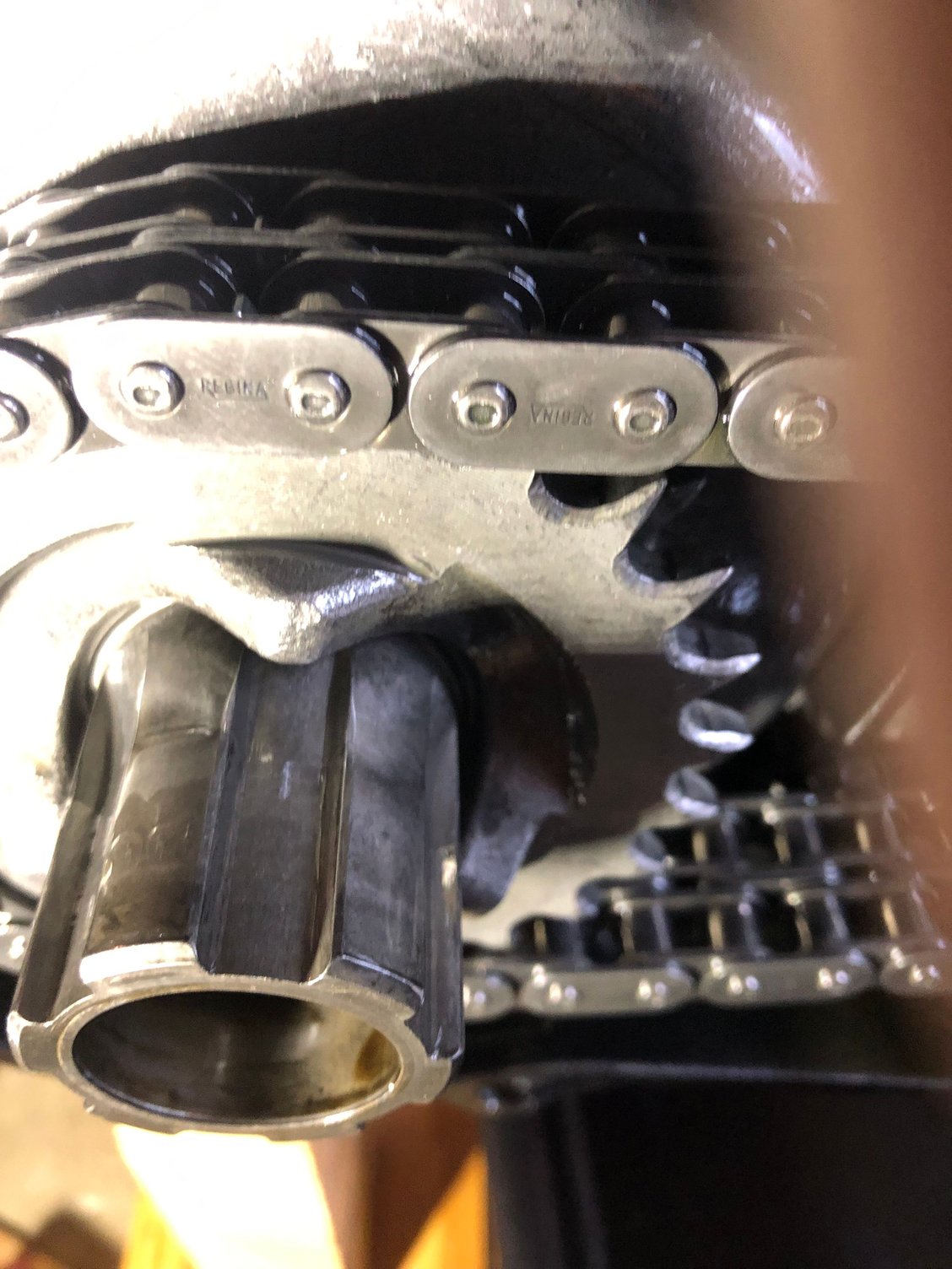

comp nut sure as sheeit loose
It will be like Christmas if all i have to do is re-torque and my bike will be "fixed"
I'm going to attempt to make the sprocket stop out of poly/nylon cutting board
KTF

Good. Trim 0.060 off the bottom of the nut and you should pull the rotor to check the splines on the rotor. Unfortunately you'll need to pull the clutch also.. Remove the tensioner when using the jam bar.

Originally Posted by Cap77
co
KTF
I have heard of that. Of a rag. I have cut 2x2 pine cutting to length. For years I used a hunk of snowmbile slide, like cutting board. I bought the modern tool which is hunk of metal between teeth. For years, and in my manual when I did it they used the steps. Some people say that stresses the crank or something. When I used that tool, I found it a little funny trying to get in place and tighten without falling out, Got it off ebay for $10-15
As said you sure had low miles. Those engines were not know for anything bad. I do remember people talking about loose comps years ago. 2003 they changed bearings. And I suspect maybe that was the issue. They used the old process, and for some reason it needed new procedure
Clutch is left hand thread. But you probably don't need to touch that. Could give low tq since are this far, flip a coin.
Clean the treads good.
KTF
Don't use that by jamming between the chain and sprocket.. You can mess up the crank or tranny mainshaft..
