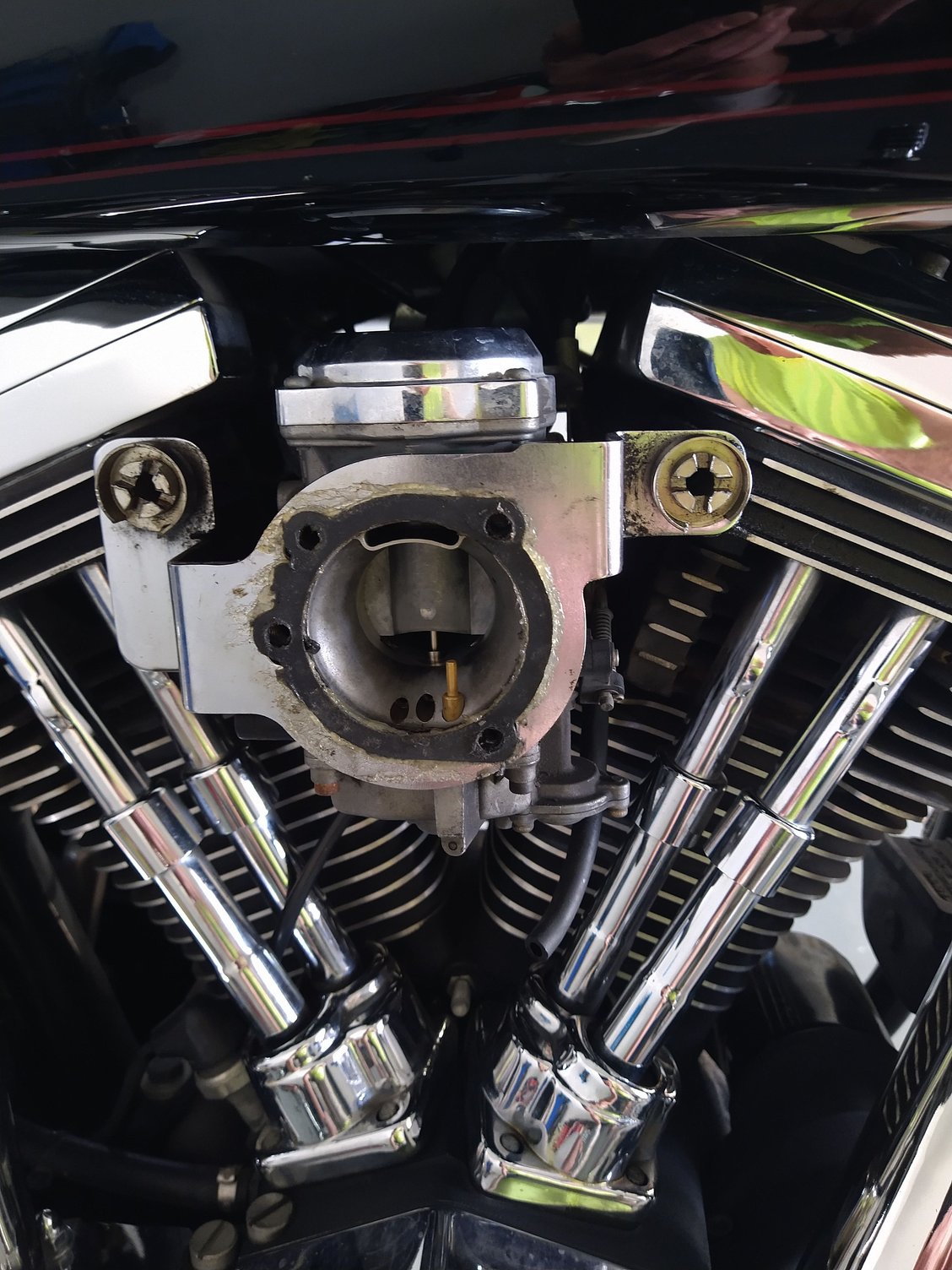

I purchased a 99 Softail Custom a few years ago. Previous owner installed a Kuriakyn Hyper Charger. The carb needs to be rebuilt but, the mounting bracket bolts are like none I've ever seen. I've tried a wide blade screw driver with no success. Is there a special for these bolts? Thanks!

Those are Kuryakyn breather bolts. There is no formal tool to remove them. They've been an issue for years apparently.
Ideas in this thread may help.
https://www.hdforums.com/forum/gener...her-bolts.html
Good luck. Let us know how you ended up removing them.

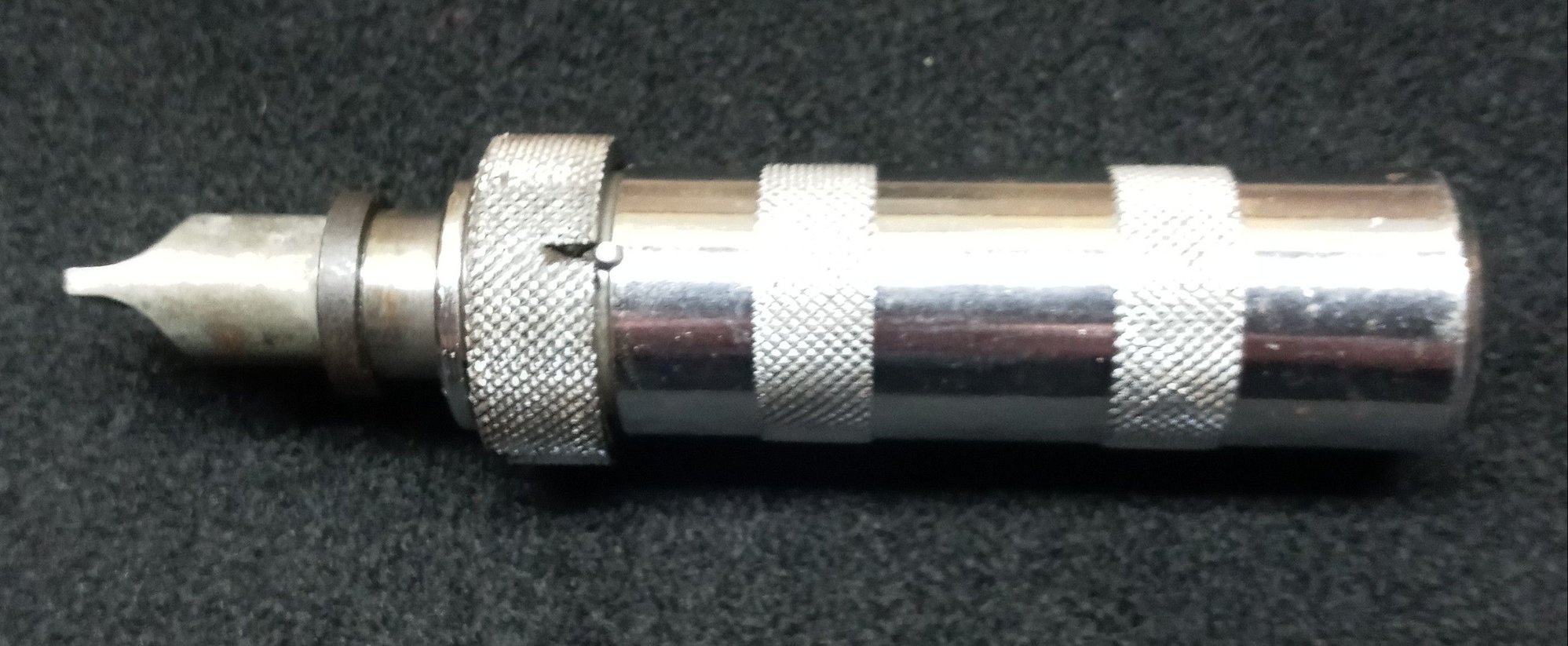

I would use a 3/8" drive drag link socket coupled to a 3/8" drive handheld impact driver.
The straight cut tip reduces the possibility of cam out that can occur when using a tapered tip screwdriver. The impact driver aids in loosening stubborn fasteners. The tip dimensions of my socket are 1/8" wide X 11/16" long. Other sizes are available.

Flat chisel is my first thought. You can put an adjustable wrench on it also it it doesn't break loose easy.
