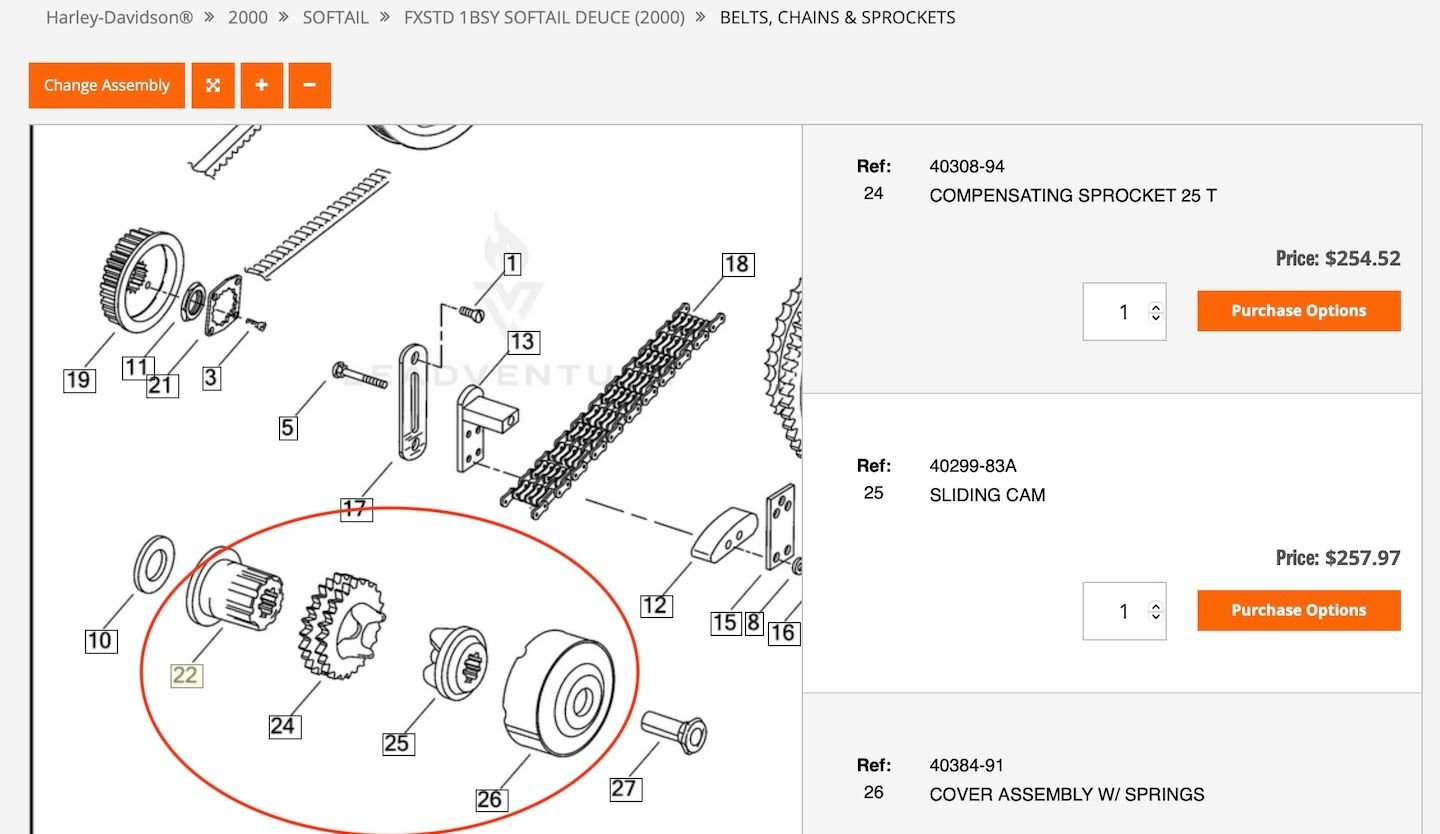

PS- The #42200064A comp is the new style comp and won't fit your bike. It's for the '09+ models that didn't get the new style comp of the Rushmore bikes in 2014. There's another one #40100061 that retro fits the new style comp of the Rushmore bikes, to the '06 to '11 models that got the problematic "upgraded' version of the comp.
If you want a new comp, you'll have to take yours apart, and replace the worn or damaged pieces "a la carte". Basically figure out what you need, #22, #24, #25, and/or #26 in the parts pic below. The #27 Comp Nut is no longer available from HD, it's an obsolete part #40392-91. Hopefully you won't need to replace the #10 Spacer, #29960-91A, because it's not only obsolete, but if that is damaged, you'll most likely need a new bottom end...
#22 = #40266-85 Shaft Extension @ $234.88
#24 = #40308-94 Compensating Sprocket, 25T @ $254.52
#25 = #40299-83A Sliding Cam @ $257.97
#26 = #40384-91 @ $218.00
