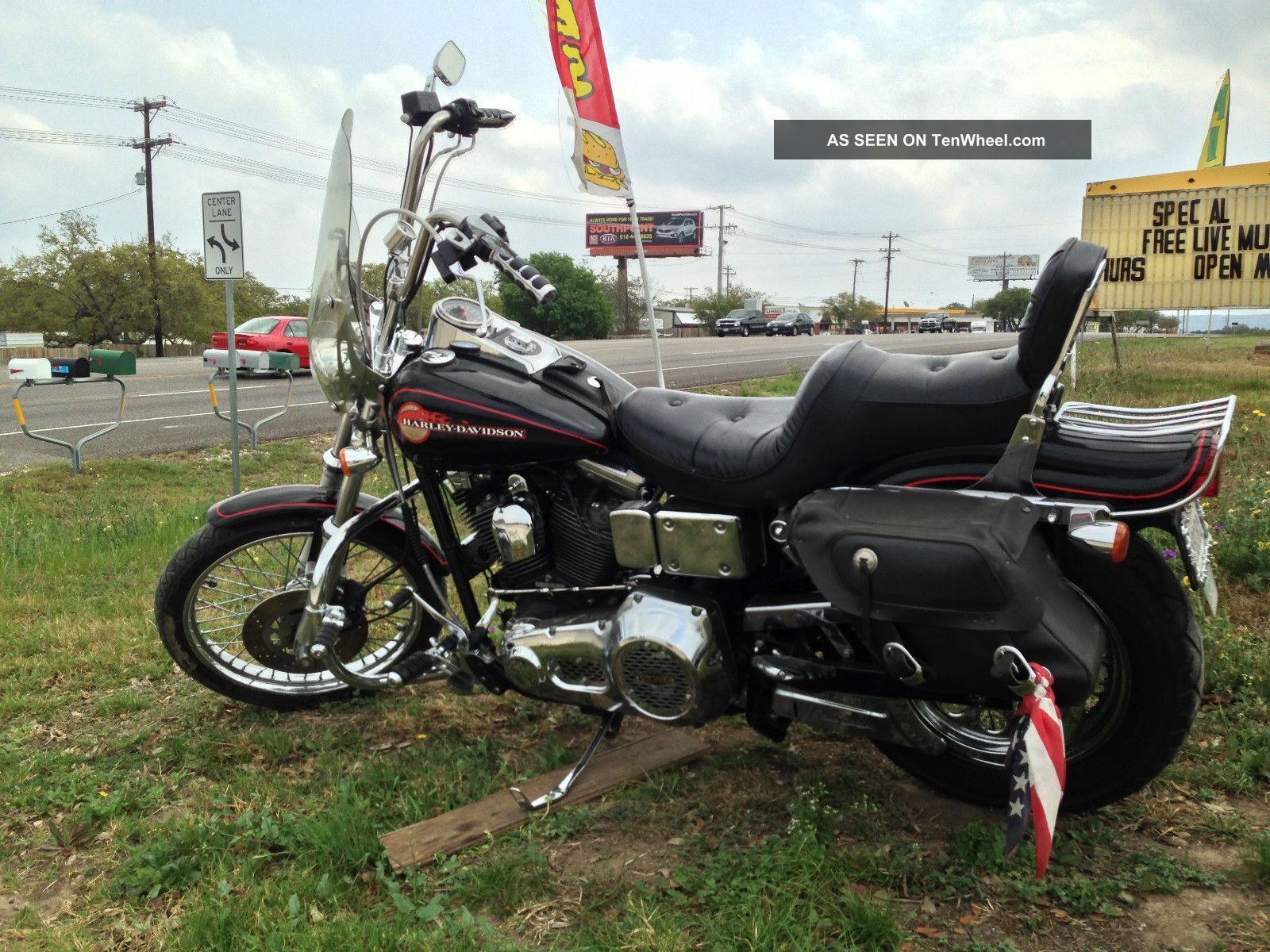

Edited: He was right pictures will not post to this thread and the OP's thread count is not going up.. @t150vej is there something you can do?? thanks..
This is a test for @Bone Doc

WOW that was weird, after I edited my post and saved it the pic appeared..
