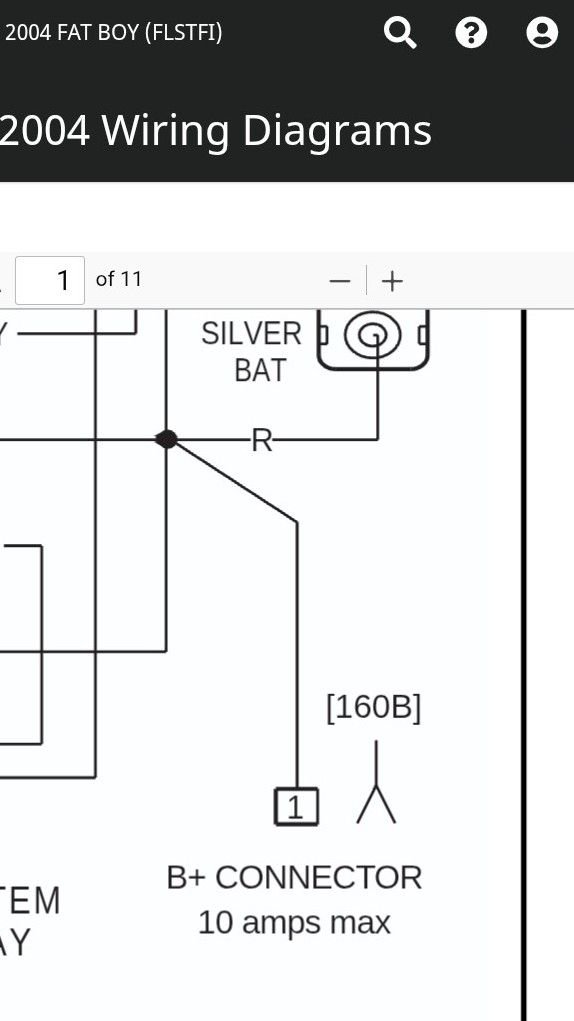

I have 2004 FLSTFI and while trouble shooting an electric issue I found a Red wire with a gray connector that wasn’t connected I tested for currency and found it to be hot regardless of the position of the ignition/acc switch. I was wondering if anyone know what this wire is for.

B+ connector. Typically used to add accessories that require unswitched power. It's protected by the 15 amp battery fuse. To be on the safe side, it is recommended not to exceed 10 amps.

I originally thought it couldn't be the B+ connector because it had two wires going into it....
Then I realized it was my old eyes playing tricks on me, it IS a single red wire....
Here are the wiring schematics for your bike.

Talk about old eyes. I misinterpreted the diagram. Apparently, it is unfused. In any case, it is recommended not exceed 10 amps.
