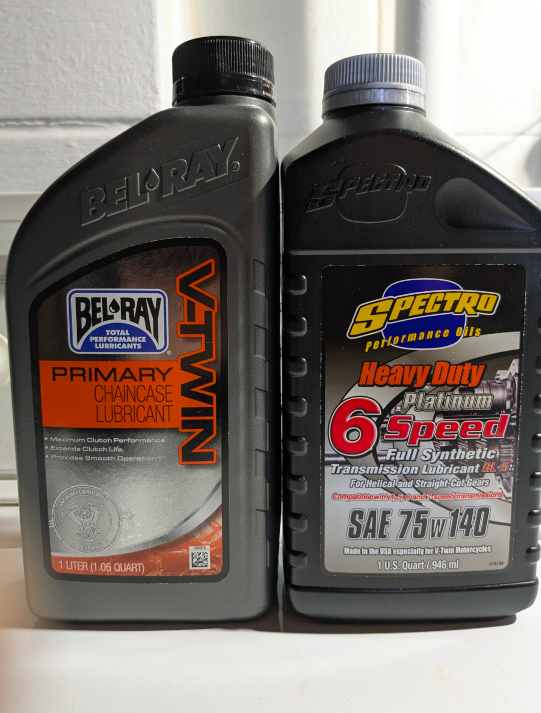

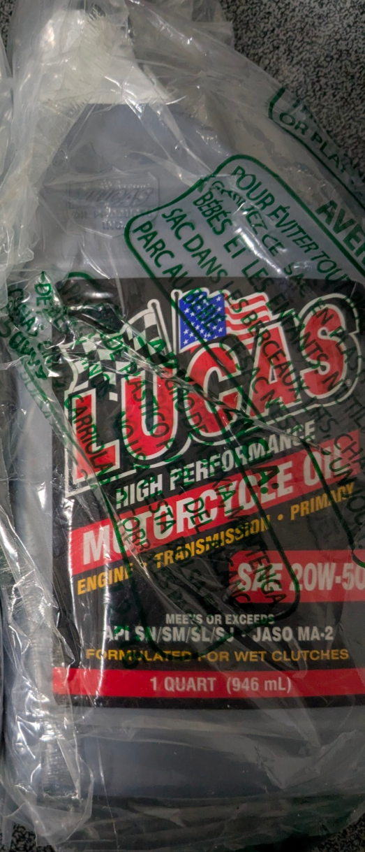

Originally Posted by Robertbc3141
Oh boy an oil thread!
My choises.
The Spectro because you can really feel the difference shifting even though it's crazy expensive ($28)
The Bel-Ray because it's 38 ounces (1 liter) and it exactly fits the primary.
And the Lucas because it's a quality dino oil crazy cheap ($40 for 6 quarts!)
As long as you don't use the same oil for all three holes like the dealership.
There is a better oil choise for each one whatever you choose.

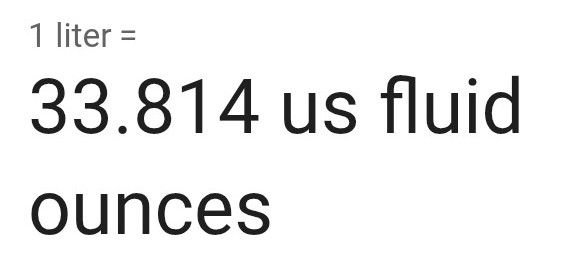

Originally Posted by barneyboy
Oh boy, I misstyped 38 instead of 34.
However that is what my Electra Glide takes - 34.
But wow, the rest of my information must have been spot on, that's kind of surprising.
I hope no one ruined their transmission by overfilling with my advice.
I stand corrected and myself reprove.

Originally Posted by snoopdog
Well, I'm really totally unqualified to comment, but I am a syn fan on just about anything. I just changed mine to the Lucas product. Seems like it was 20 per quart, but not sure.
While the non synthetic Lucas conventional dino motorcycle oil can be had on Amazon for $40 for 6 - under $7 a quart.
Can change it 3 times as often.
I know a lot like the synthetic but I don't leave it in there long enough to justify it.

My previous owner always used the dealership for his yearly oil changes.
I have a stack of 18 receipts for $280 oil changes where they used the same HD oil in all 3 holes (That's $5,000!).
Well a little less, some of the earlier receipts were for "only" $240.
I do appreciate that he took care of it - or rather had it taken care of -
and maybe should have left it alone - but, I like to do the work myself almost as much as riding, I find working on a motorcycle fun and relaxing - especially when nothing is broken So researched what might be better for the trans and primary.
On almost every receipt was the note "customer complains it's hard to find neutral" then that they could find nothing wrong.
I rode it on his latest oil change for a few days, I thought it shifted fine and could find neutral pretty easy.
Then I put the Spectro in and it changed the way it shifted to like butter, and neutral is way easier to find.
Made the way it shifted before seem bad.
So I'd stick with any of the $30 ones - it's only a quart - other than the regular motorcycle oil.
Here's a money saving tip....
I too just happen to use Bel Ray oils for the primaries and transmissions of my bikes...
I was told many years ago, that the Bel Ray "V-Twin Primary Chaincase lubricant" is the exact same oil as the Bel Ray "Gear Saver 80wt Transmission Oil".
I sent an email to Bel Ray, asking them if that info was true. They confirmed that info in their email response.
Now, when I stock up my oil cabinet, I buy/use whichever of those two are cheaper in my primary. I have seen over the years, that the Chaincase lubricant can be $2 to $3 dollars a bottle more than the Gear Saver trans oil...
When buying oils to maintain 4 motorcycles, that $2-$3 a bottle adds up.. OK, I'm also cheap..
