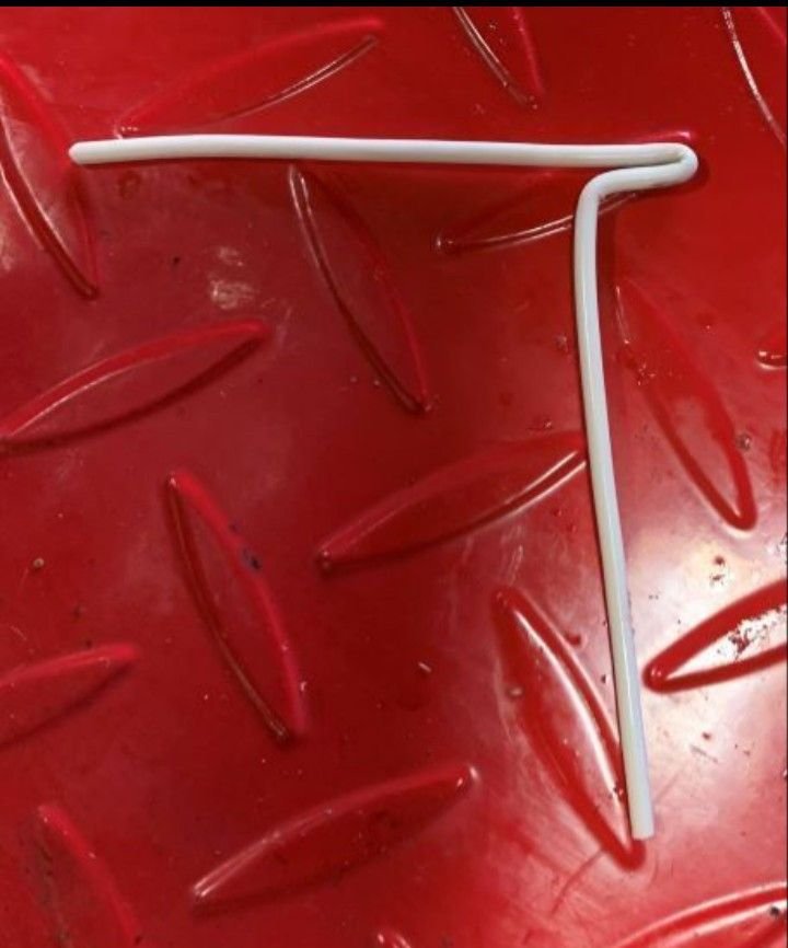

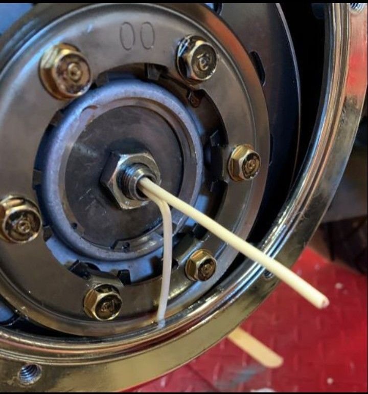

Use a jack, use a friend, lean it against a wall. As long as it's upright, check the oil level. Which is always a needlessly difficult job because of the way Harley shapes the primary cover. God forbid they make it easy to see the oil level, or install a window or dipstick.
That's what I mean!
To see that level you have to have your face almost on the ground.
People taking me to task for calling it a two-man job.
No it's not absolutely required.
You know what's also weird - or at least inconsistent -
you check the oil with the dipstick threads screwed all the way in but you check the trans level by just resting the dipstick threads at the top not screwed in - both on the jiffy stand this time.
At least my bike - 2008 Electra Glide Ultra Classic.
And I know that varies with different bikes.
I thought your homemade dipstick was a brilliant idea to make checking the fluid level easier.
