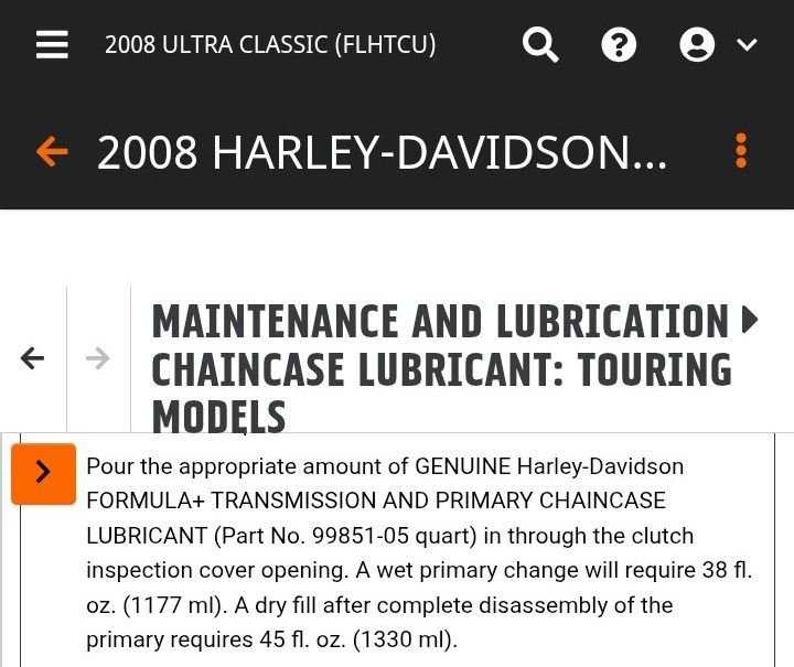

Your owner's manual recommends 38 oz for a wet fill. Are you saying 34 oz is the correct amount?

From AI:
"For a wet fill on most Harley-Davidson Electra Glides, you'll typically add about 32-38 ounces (1 quart) of fluid, but the best method is to fill to the bottom of the clutch basket with the bike upright".
And that's what I find - that liter (34 ounces) takes it up to the bottom of the clutch disk when level (a two-person job).
I do pay attention to the owners and shop/service manuals vut in this case I find 34 ounces is right.
And I know, I know, Ai isn't always right - as it told me these tires on my 2006 trailer I just purchased "will be manufactured in 2035, 9 years from now".
But I have found that 1 liter is just right.

It tells you to check that primary oil with the derby cover off level at the bottom of the clutch disc while the motorcycles is level rather than on the jiffy stand.
I'm not going to try to balance my 900 lb Electra Glide straight up and down by myself while on my hands and knees checking that level with my face just a few inches off the ground.
You don't do that by yourself.
Of course it's a two person job.
You've been checking that while it's on the jiffy stand haven't you?
If the level just barely touches the disc while it's on the jiffy stand when you straighten it up it's going to be pretty low.
Probably a little dry in there doing it that way Barney boy.
What a jackass you are.
