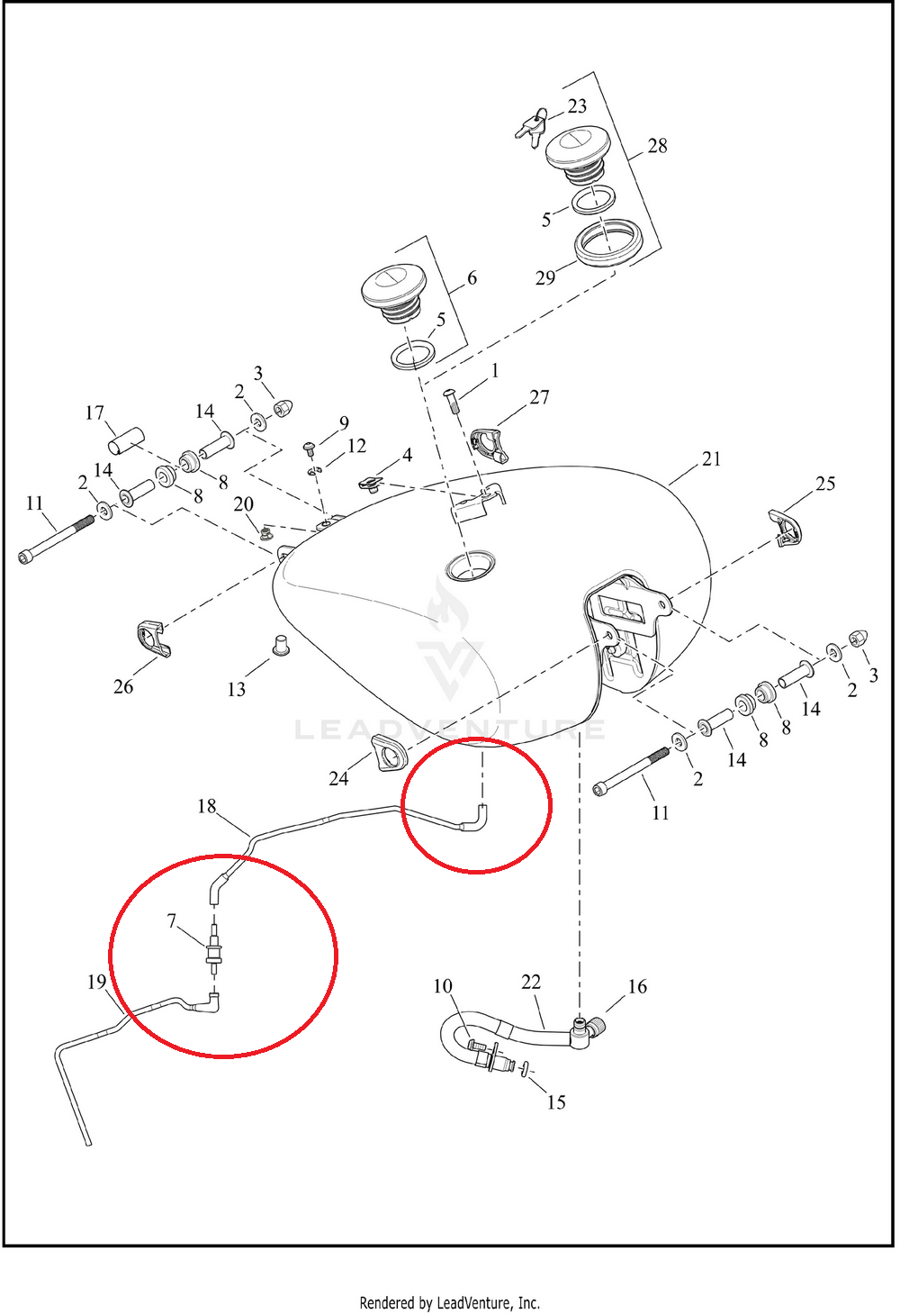

Originally Posted by CoolBreeze3646
CoolBreeze3646 showed you the two fuel tank vent systems available on 2023 Softails.
The first pic that just shows #7, the #62150-85 fuel vapor valve, is the 49 state version. It only has that old tech valve in the fuel tank vent line. The same vent valve has been used since 1985. The old style fuel vapor valve is supposed to limit any actual fuel from leaking out the tank, but does nothing to stop the fumes... That is, after all, the fuel tank vent line. It needs to vent.....
The second pic with the charcoal canister, is the CARB approved vent system that is only on CA models. It has a purge valve solenoid as well as the old tech #62150-85 Fuel Vapor Valve.
There is a third version that is used on many, if not all, touring bikes for many years. Their vapor valve is part of the fuel tank top plate. It seems to work much better at controlling both leaking fuel and fumes than the old in-line vapor valve.
Living in CA, I have a couple CA bikes with the canister. They never smell when parked and the engine is hot. My two 49 states Softail bikes, will smell if parked in my little bike garage/shop when hot, especially after a recent fuel up.
If I park within a few minutes of refueling on my 2001 (my oldest 49 states bike) when it's fully warmed up, it will actually drip some fuel from the tank vent line. I suspect I need to change the fuel vapor valve on that bike, or at least stop topping it off if I fuel up just prior to parking it...
I would say what you are experiencing is pretty normal for a 49 states Softail, with just the old fuel vapor valve. I would say the hotter the bike when parked, and the hotter the weather at the time, will dictate how much gas vapors will come from the fuel tank...
When I looked up your fuel vent systems, I was surprised to see any new bikes still using that 1985 fuel vapor valve...
