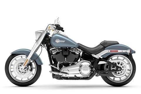

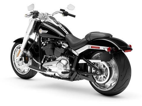

The OP has a 2024 FatBoy.... I've never seen the new "softail" mono shock frames in person, nor tried to lift one with a jack.
Do they have something that protrudes below the frame rails, that would get in the way of jacking them up?
I was curious, and the pictures I could find on the internet don't show anything protruding below the frame rails that would affect a scissor lift, or a dual rail jack....
These pics make it look like they are perfectly suited to a jack between the frame rails without any assistance? Are frame protectors even necessary?
After looking up the HD Lift, I can't see why it won't work...
What am I missing?
