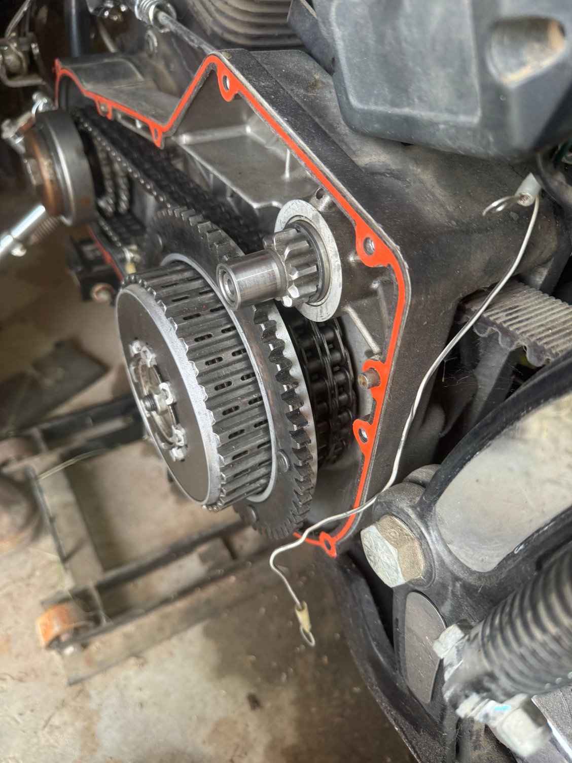

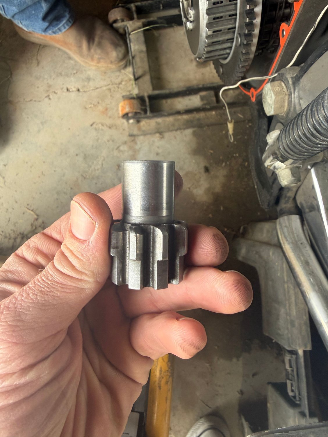

First time here so apologize if I’m in the wrong area, but I’m in a bit of a pickle. Hoping somebody could help me identify the part that I need to finish rebuilding this bike.
So my dad and I are building it. But we hit a wall with the jack shaft to starter. there seems to be a sleeve or spacer thats needed. But every kit amd jack shaft assembly ive purchased does not come with it. Even bought a starter. Local shop is no help either.
I could be mis identifying here. But what i’m calling the Jack shaft is the piece that engages to the starter however we’re missing a piece to give us the proper depth to do so anybody able to put us in the right direction? Thanks in advance. There seems to be some kind of sleeve or spacer that goes with the jack shaft to engage the starter.

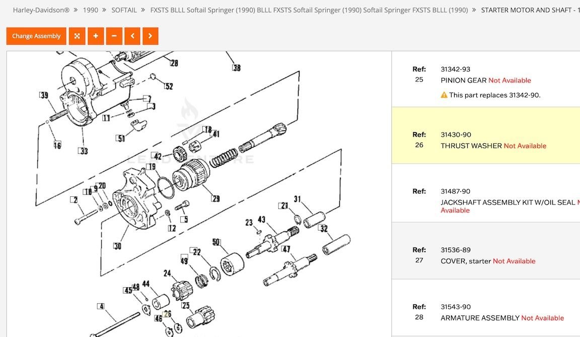

Your year had the one-piece pinion gear...
Are you looking for the #25, part #31487-90 thrust washer that goes outboard the pinion gear, or the #32 coupling, part #31548-90, that goes inboard the jackshaft?
In any case, both are obsolete and unavailable from the MoCo. You'll need to find new old stock, an aftermarket equivalent, or used...

Oops, typo on my post above.
My line' "Are you looking for the #25, part #31487-90 thrust washer that goes outboard the pinion gear."
Should read, "Are you looking for the #26, part #31487-90 thrust washer that goes outboard the pinion gear."
