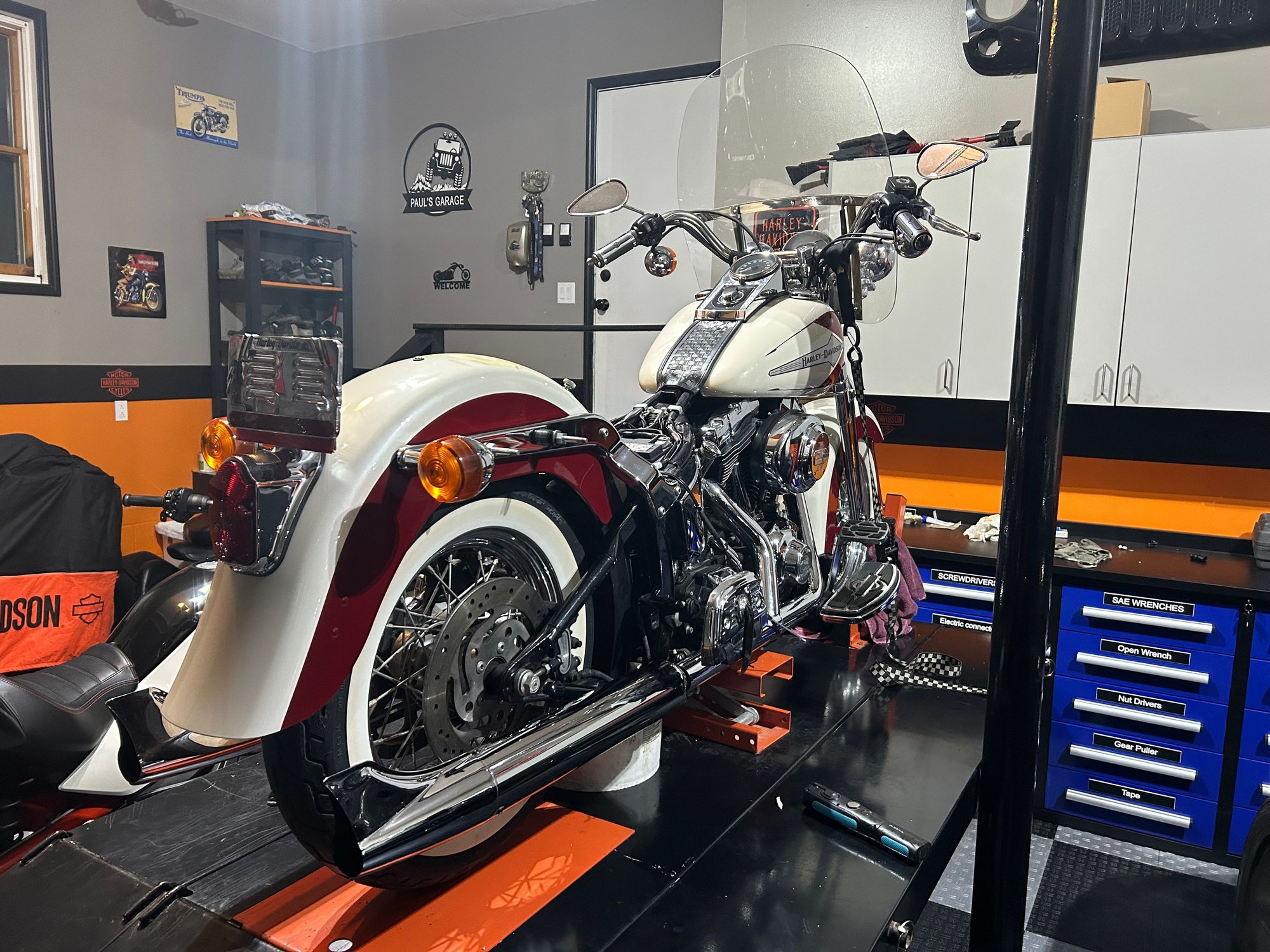

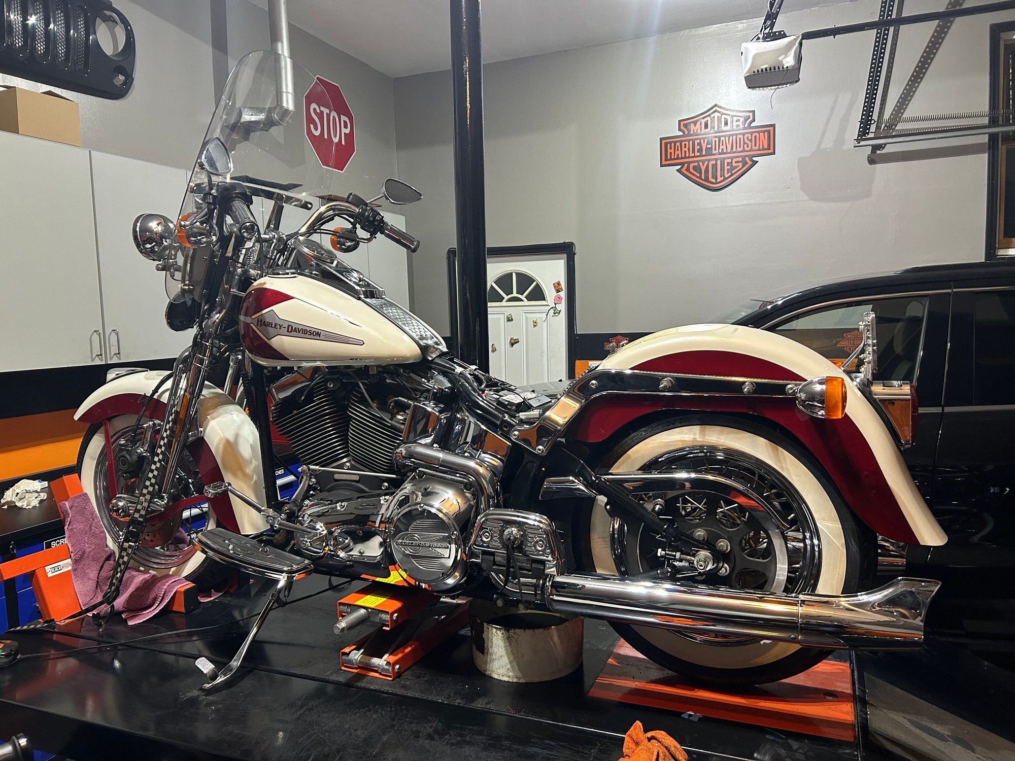

That's a nice paint scheme on that bike.

That's a damn nice set up you have there ! You'll find the noise.
Sure is !
I`d have to put a safety cable inside those exposed garage door springs before one" twangs" and busts up something nice !!
It`s rare, but it happens

Check out the labeled tools drawers. I thought I was Mr. Neat & Tidy. Nice !
