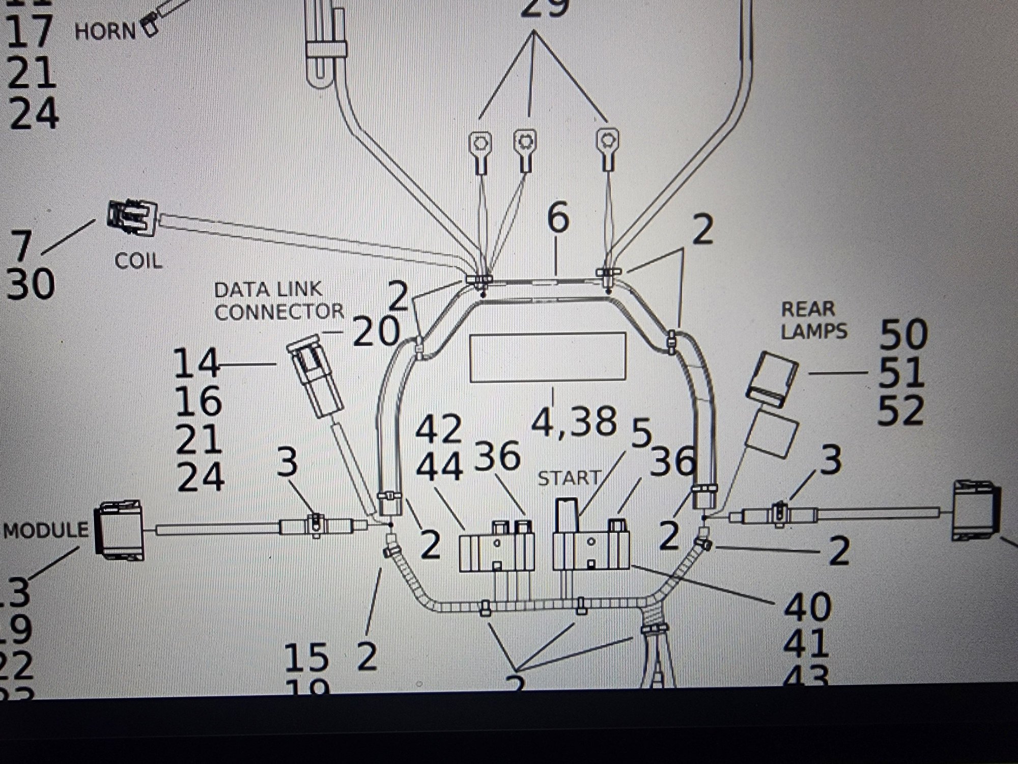

Is the plug number 14 originally for the fuel injection? It doesnt say what it is it just says plug, and it also has a rubber plug  in the center of it to seal it up. My bike is 03 FLSTC.
Is the plug number 14 originally for the fuel injection? It doesn't say what it is it just says plug, and it also has a rubber plug in the center of it to seal it up. My bike is 03 FLSTC. Carbureted.

Your manual has a page listing all plugs by number and location

It says Data Link Connector directly above the connector. Used for tuning, reading codes, etc. on efi bikes.

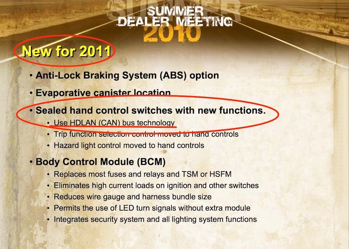

I know Softails went to the Canbus in 2011, I believe Dynas went to the Canbus in 2012. Touring didn't go to the Canbus until the Rushmore bikes in 2014....

FWIW......
From the "2011 MY New Model Technical Forum" presented at the 2010 summer Harley dealer meeting....
