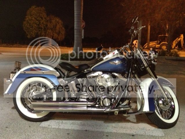

thanks for the input guys, ill definitely consider painting the plastic under the seat red. funny how in pictures it looks orange. its radical paint set number 54/200. i also have chrome mid-frame covers for under the plastic. just waiting for a warm day to put them on.

Default What is needed to do this?
Originally Posted by lovemydeluxe
thanks. the guys down at my local HD service department did a hell of a job matching the seat hardware to the narrower deluxe rear fender. i havent stopped smiling since...
I know this is an old thread, but this is a modification I have wanted for my 2005 Deluxe since the crossbones came out. When you say they "matched" the seat hardware to your fender, what exactly do you mean?
What are all the parts you had to buy to attach the seat to your bike? The seat and what else?
Thank you so much for putting the photos up....I had asked a guy in service if I could do that and he said anything is possible but it's probably very difficult and expensive...so that turned me off to the idea..until now.

Default Softail Deluxe to Crossbones Seat
For what it's worth, I discovered that it was not a direct bolt on after all.
The black cover that goes under the seat, covering the battery and electronics that comes with the Crossbones did not fit properly without being cut/trimmed to fit.
Holes needed to be drilled onto the cover for it to attach to the fender bolts on my deluxe.
Probably the biggest modification needed is that the seat swivel on the Crossbones seat (at the front/neck of the seat) has a bracket with two holes. Those two holes were missing on my Deluxe frame. My Deluxe frame had two holes about an inch and a half lower, where a few ground wires were connected. I went to the dealership and they pulled the seat off a Crossbones for me to look at. The swivel bracket on the crossbones was bolted to two different holes drilled about 1 1/2 inches higher up on the frame, which are not present on my Deluxe. I saw where they were, and I purchased the two bolts used to attach it.
I used a drill and drilled the two holes undersized, using the bracket as a guide pressed against the frame. Then I used a simple tap to cut threads in the holes, used some WD40 to lube it as I twisted the tap. Took me about 20 seconds to thread each of the two holes. Swivel bracket then fit perfectly, bolts screwed in with ease.
Seat is now mounted properly cover sit fine and looks like it belongs there.
Since doing the seat swap, I consistently get people waving me down at stoplight complimenting me on the bike, and no doubt the seat is a huge factor. the bike just looks totally different with that seat, with those springs.
I did find that I sat alot higher now on this seat than on the factory seat..something I DONT like...but I accept it because it looks so much nicer. I replaced the 3 inch springs on the seat with 2 inch springs from JP and that has brought it down to a more comfortable level.
