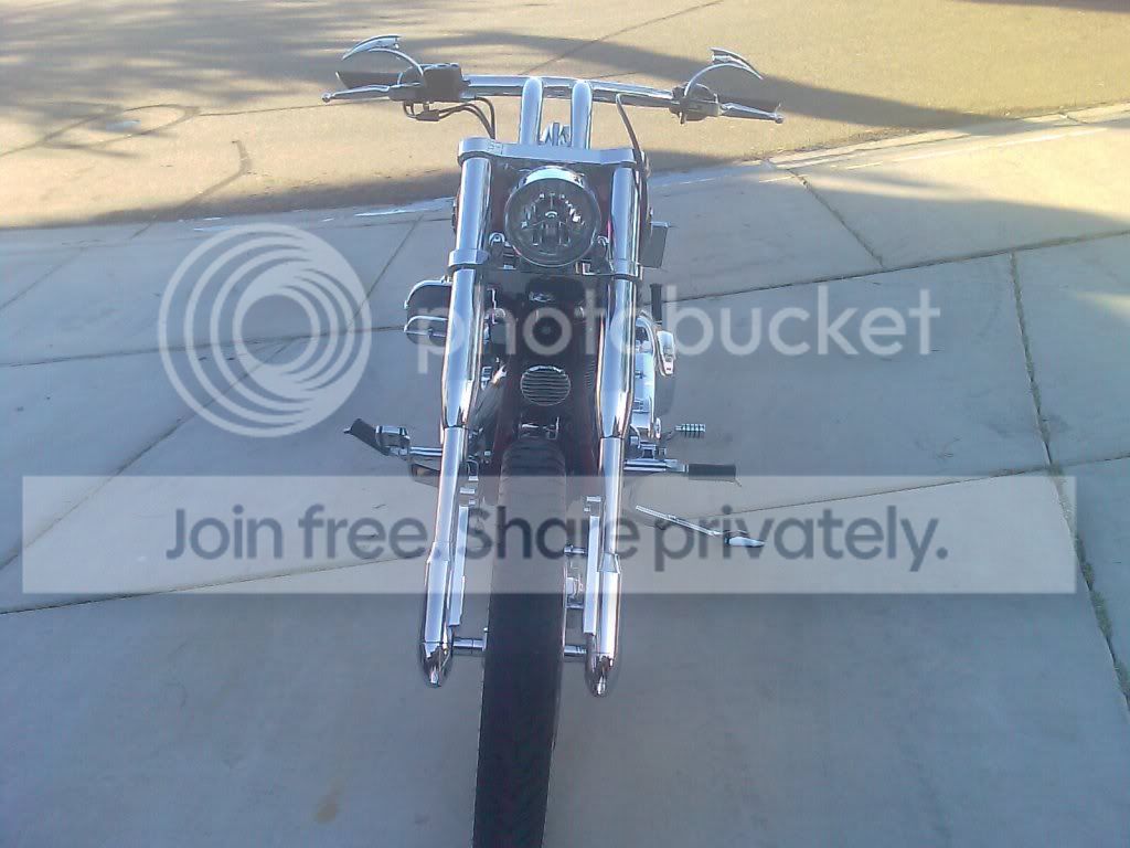

Ok, Now im confussed with you guys that mentioned if you turn the bars to the left it will fall over, I could understand that with a short kickstand but with a longer one and the bike lowered I would think the bike would be easier to fall over with the bars to the right.. Mine as it stands it almost straight up but i feel more comfortable with the bars to the left and not the right, it still has the lean to the left... Check it out

Got the kickstand problem solved today. Took it to work and had a guy put it in a brake press and added ~3 more degrees to it. Added it right at the first bend from the top. Bike is now leaning at roughly the same angle as it did stock.
Bars to the left means the left handle is pushed out, pointing the tire to the right. Opposite for bars to the right. Some people say bars to the right when they mean which way the tire is pointed, so it can be confusing.

And for some more info on the kickstand, it is mounted to the floorboard mount, so if I would have fabbed a wedge it would have tilted the whole floorboard.
