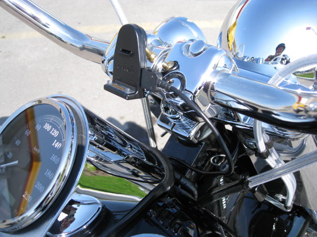

Today I hardwired my power for my GPS (Garmin nuvi 760) and installed my GPS mount. I wired the power to my ignition and tuck the plug down into a hole under the handlebars when I'm not using the GPS.
Still looks nice and clean.
Here's some pics.

Hardwired means that I don't have to plug the power cord into a cig lighter or anything else. I cut off the cig lighter plug-in from the power cord, soldered a fuse holder onto the power cord, then attached the other end of the fuse holder directly to the ignition switch.
The power cord is hidden when not in use and tucked safely away.
When I pop my cradle with the GPS onto the mount, I only have to plug the power cord into the cradle.
