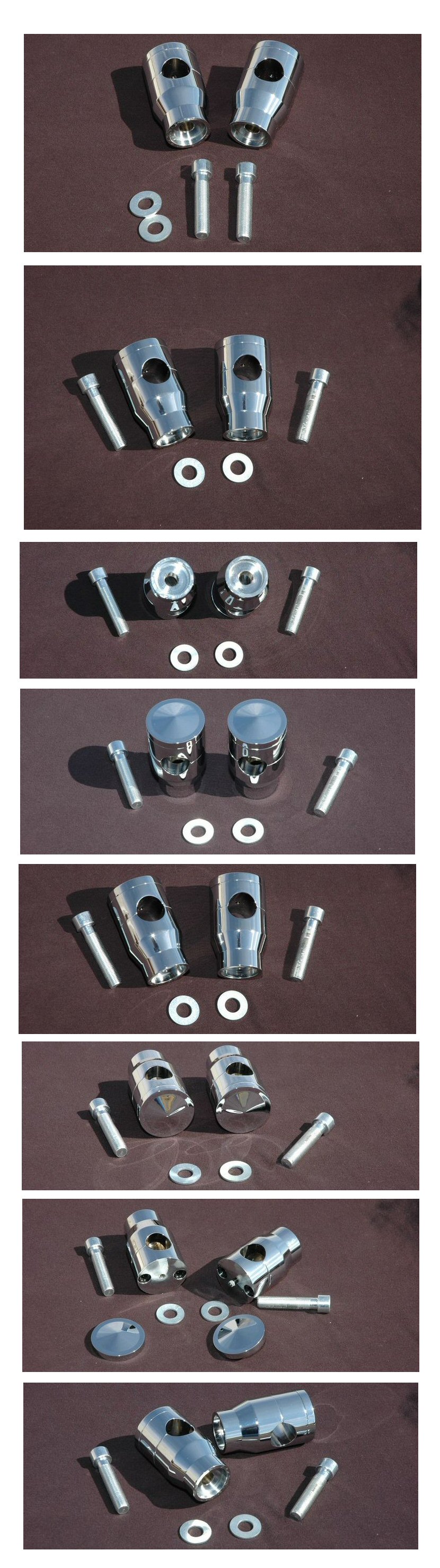

here is another site that has the riser stud conversion
http://www.debrix.com/ProductDetails...ode=37-0864-VT
think it will work but my main question is what do i do about the rubber bushings.
you can see in the pic here that the risers have a recessed area on the bottom for rubber mounting but im unsure how i could do that on my setup
I doubt you'll get bushings in there with this set up. Its a solid mount with room for you to add a rubber washer? - to help illiminate some of the vibration thru the bars. I'd take that washer that came with the kit around with you and look for a rubber washer - plumbing? - that you could compress in there when you fasten it down. The switch many guys do from Rubber to Poly bushings accomplishes close to the same thing as these solid mounts do. Firms up the risers, removes much of the flex but transmits more road vibration to your bars

In case this will give you some help and perspective... On the left is the stock riser and riser stud setup. On the right is the Gooden Tite riser stud conversion. Both kits use a 3/4" bolt/nut to attach the riser to the stud. I used a standard Craftsman deep socket (in both 3/8 and 1/2 drive) and they fit in the riser without a problem. Getting the riser stud off the trees I taped the tops of the trees to prevent scraping and used a good adjustable wrench as I didn't have a socket or combo wrench that size.
All the riser stud conversion kits you are looking at seem to have male ends. So no matter which one you go with, you'll likely have to ditch the bolts that came with the risers and instead use nylon locknuts with washers like what is used on the stock setup.
It appears that the riser stud conversions here: http://www.debrix.com/ProductDetails...ode=37-0864-VT are the best fit. The others look too tall for the risers you bought. The top of the riser stud would interfere with the bars once everything was installed.
You are right, the depression on the bottom of the new risers does not appear as if it will accommodate rubber/poly riser bushings. Instead you are probably looking at needing to add a solid mount riser adapter kit like this: http://www.debrix.com/Riser-Solid-Mo...p/41349-m1.htm
Seems like the Ebay vendor wasn't completely accurate when they added "Springer" in the title. Seems like you have to go through a lot of adjustment and are needing a lot of additional parts for a set of risers that are implied to fit a Springer. Nowhere else in the write-up does it suggest they are Springer specific. I've bought from ACM a lot before without incident. Maybe this was a goof.
