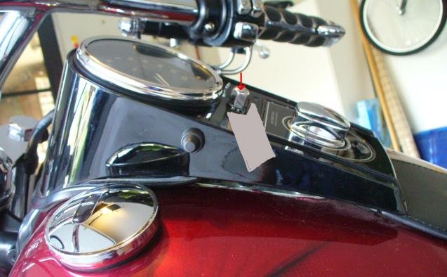

Originally Posted by Alien Spyder
. A notched putty knife might do it.
I certainly don't want to force the dash up any more than I have too.
If the nut isn't tight, slide the putty knife between the nut and the washer, not under the dash
Pardon the (non)artwork, the V notch should be steeper (to wedge the bolt).
