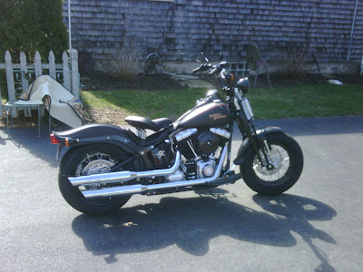

Fork Oil? Whats this fork oil, is that like a left handed screwdriver, or a bucket of elbow grease ?
Get a springer and you'll never have to check your fork oil again
