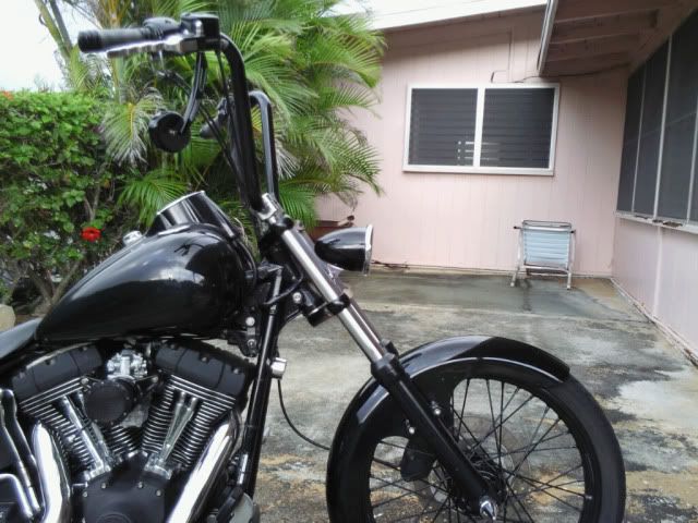

i think the tank lift looks good but......i think you need to have the decals redone on the tank,(harley-davidson) the lines dont look right, if you look at story's bike he has the lift but because he does not have decals it looks like the lines work...just my 2cents

Thanks Jump... I appreciate the kind words... I have a 2" or 3" adjustable kit... I tried it both ways set at 3" it looked freaky wierd... I wouldn't go over 2" on a tank lift you'll see the square section of the frame and all the wiring. Some people like it on my bike and some people don't but thats the way it goes with just about anything we do to our bikes. The one thing I luv is that if I need to work on some thing like Trottle cables, handle bar wires, and headlight wires I don't have to move the tank back I can reach everything just like it is.
A kit should come with everything you need. Don't do it with a full tank and have a extra set of hands around it'll help. I did it by myself and lost a lot of gas... lol As for the rubber piece in front the tank it's history out of sight out of mind.
The NT is mine 2" tank lift
