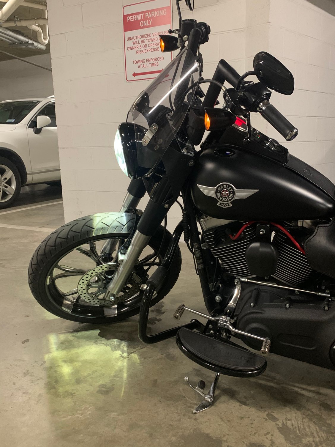

I plastidip’d the windshield mounting plates. Good call.

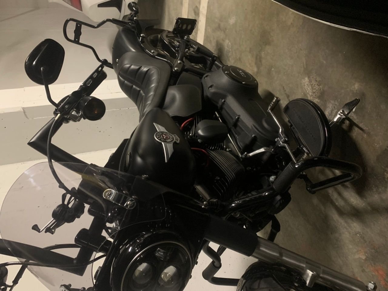

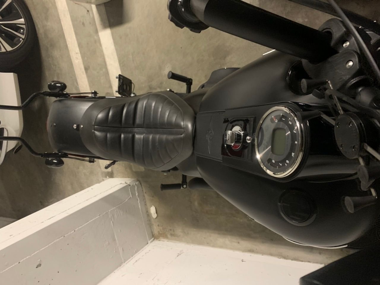

Put the new seat on. RSD Enzo solo. It’s a few inches narrower than stock.
