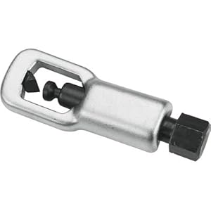

It is a carriage bolt. I had one mess up on me on my Low Rider. Nothing I tried would work. Except this.
Go to Sears or the auto parts store. Ask for a nut cracker. Yea, laugh. that's what it is called. Or nut splitting tool.
You can get them at autozone, sears, napa, ect.
I cut a thick piece of leather to lay acroll the console with the nut sticking through. You have to hold the tool with a wrench or vice grips.
Be careful.
Once you get it off you need to inspect the holder for the carriage bolt. It should fit snug.
