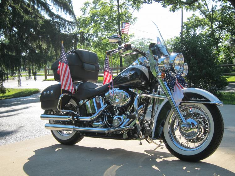

Wife has the Rush 1.75s on her Deluxe. Over my objections she chose the straightcuts. After getting used to the look (I have the slashdowns) I think she made a good choice.
No remapping needed with the 1.75s. Generally recommended with the 2.0s though several members have said they're doing find with that setup.
I find her pipes sound better than mine. Don't know if that's because of the straightcuts or the shotgun exhaust configuration. Since even her stock exhaust sounded better than my stock I'm leaning toward the latter being the reason.
