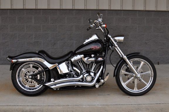

Yup, it is an old thread. I did a search! I am looking for a 2007 Softail and I am trying to learn about the differences between the Softails made in 2007. I want the 2007 because it is the only Softail that has the 96b twincam motor and the 6 speed trans. It also has the big 200 series tire. I do know I have to have the black motor!
I became interested in the 2007s when I started looking at putting a big tire, 96 cid motor, and 6 speed trans in my '90 Springer. I think I am better off, cost wise, to get a 2007 Softail and put my Springer front end on it. If that is possible?
Thanks, Shimaze

The C is for Custom. It had a 200mm rear wheel and bobbed fender but was basically like all the other softails as far as parts go. The Deuce (D) has a longer neck or backbone on the frame with a solid 160mm rear wheel and slash cut fender. The standard backrest will not fit and several other parts had to be made just for that model. I put a 2007 Custom wheel on my Deuce but it takes time, money, and a right angle grinder if you done get a specific wheel. Even then the disc has to come off the wheel to get it off the bike. Looks awesome though. The bike in my sig is a Deuce.

VI, thanks for the reply. I guess the frames between the three Softail models are different, as is the ability to use the 200 tire?
This is 2007 Deuce
This is a 2007 FXST
