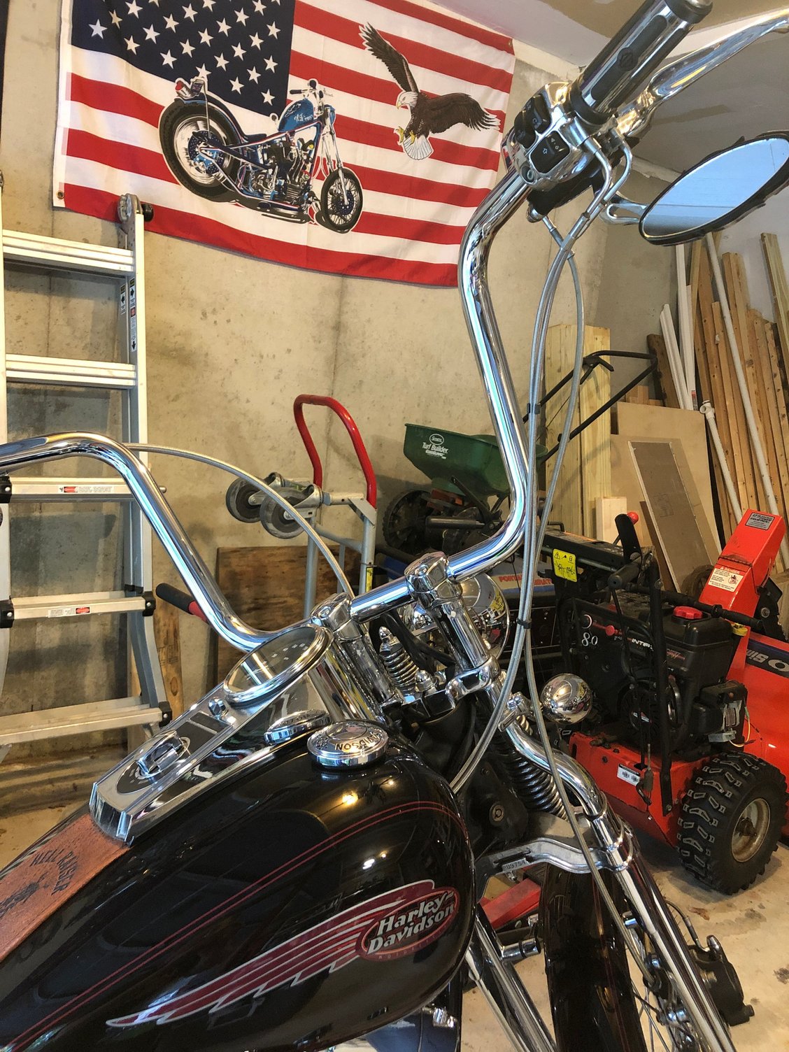

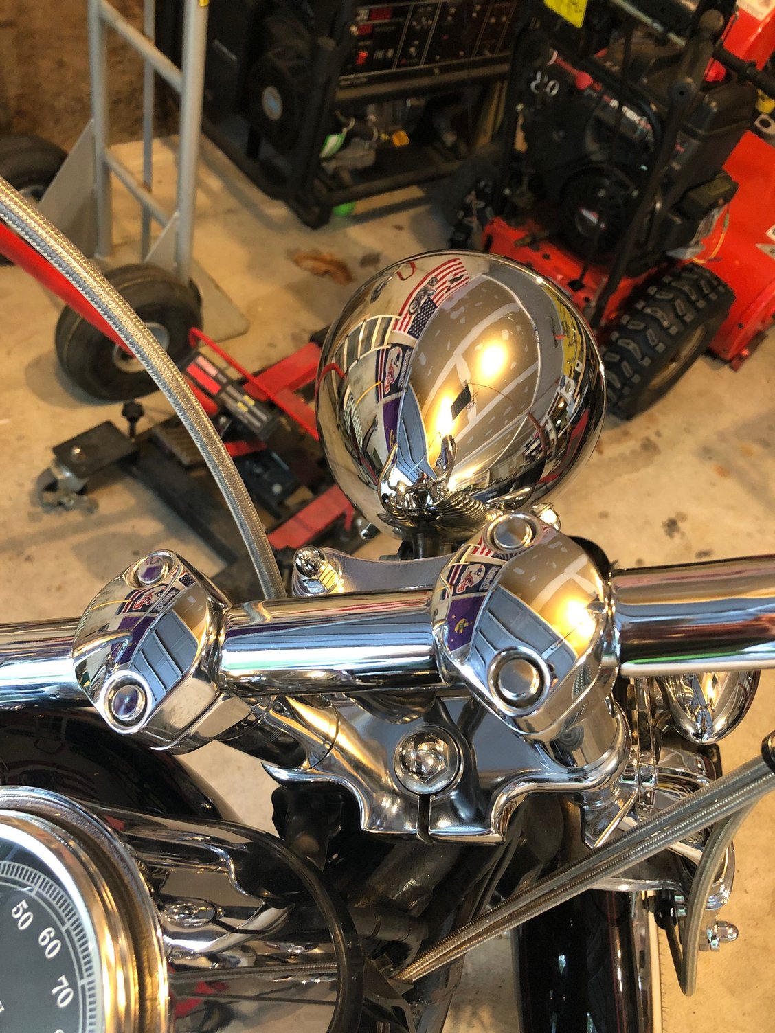

Old May 22, 2020 | 05:56 PM
Scott Lessard's Avatar
Scott Lessard
Stage I
Joined: May 2020
Posts: 1
From: New Hampshire
Default Fixed my issue!
Originally Posted by gcarnevale
I have a 2005 heritage springer classic that I installed 16'' ape hangers onto. The problem I am having is that they keep coming loose after I ride. The teeth on the bars sits in the hole on the riser to attach it to the fork so the teeth aren't biting on the clamps. Do I also need to replace the risers to aftermarket ones? Anyone have any good suggestions? Thanks!

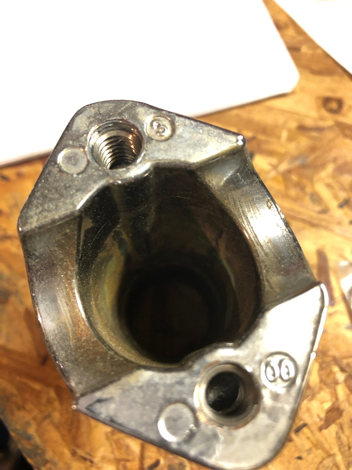

I had same issue with my 2001 Springer. I tried small squares of window screen and that didn’t work. Tried JB Weld. Didn’t work. Tried boring a cavity in the top plate of riser and inserted a 5 sided screw in the bars that would set up inside the top of the riser cap. Kind of worked. But not perfect. Had move to still! The final fix, and it’s worked for 8 years running was taping out the threads of each riser and inserting steel threads. No more Ofer torquing. It’s rock solid. And that’s with only 2 bolts per riser!
