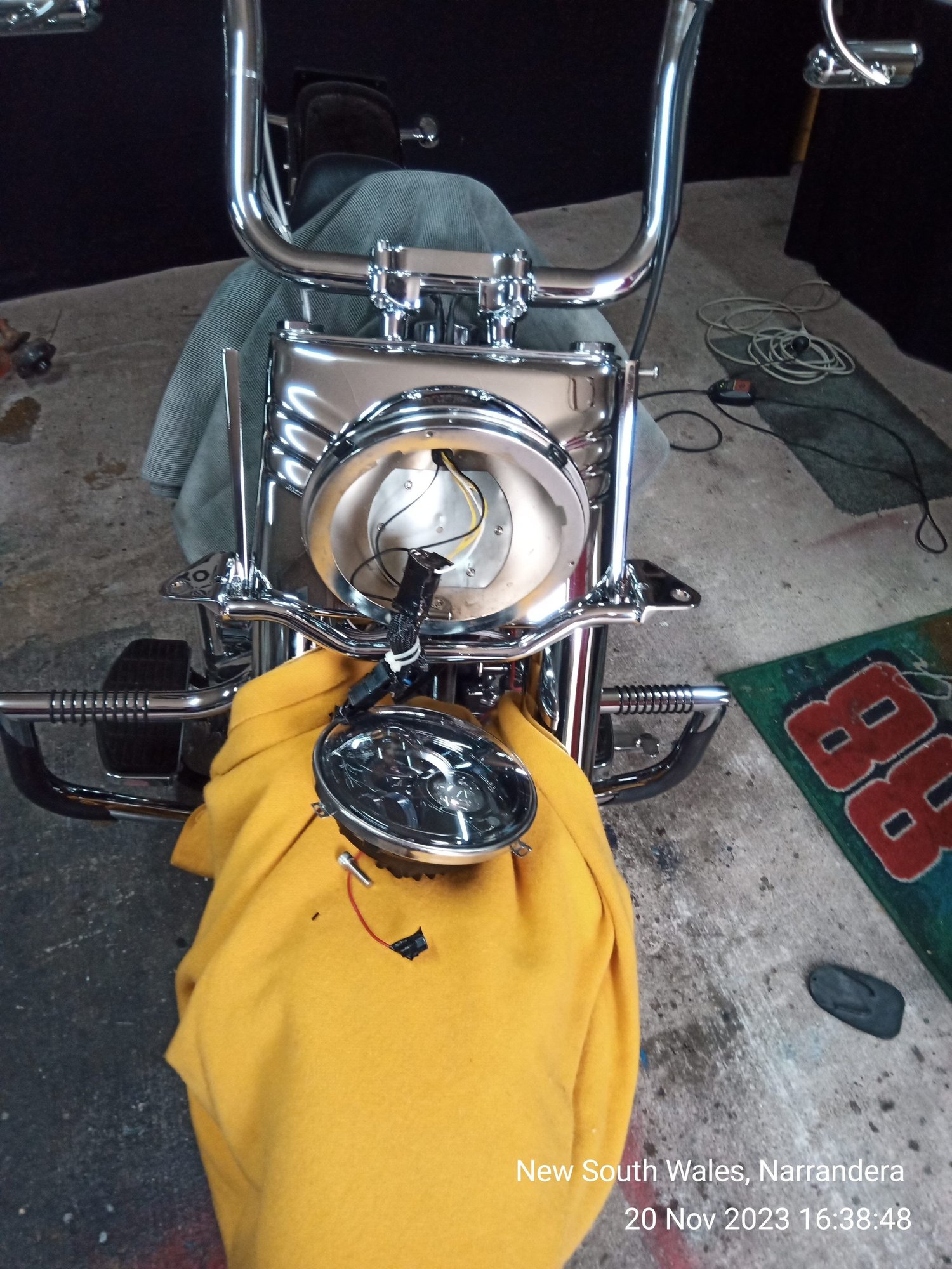

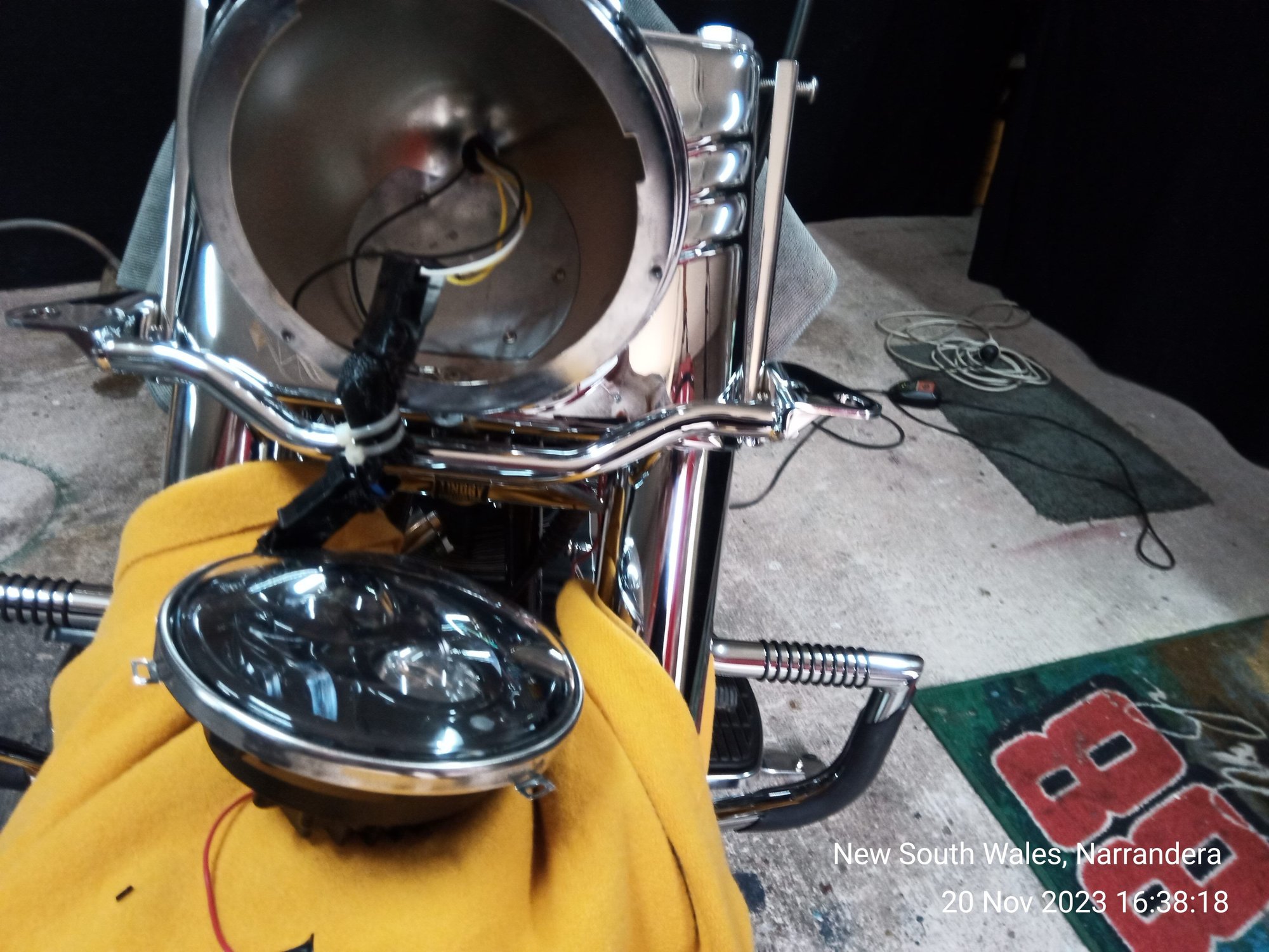

apologies for reopening this thread, but also having the same issues. No matter what I try, this bracket just will not fit. Before I purchased it, i triple checked with the dealer that it would fit my 2003 Fatboy and he assured me it would and we both read the specs and it certainly should. However as you can see from the photos, it does not. The 'bar' part of the bracket seems to hit the chrome 'narcelle' behind it, which stops the holes lining up. No matter how I jiggle it, it won't fit. I am 100% positive my bike is dead stock front end, so it's not some after market issue. I've rung the dealer and sent him the photos and all he can do is tell me it should fit , he's sold heaps of them and there has not been an issue before.
So, here's hoping someone on on this forum can use a fresh pair of eyes to see what is wrong with this?

Well, looking that that headlight shroud, or nacelle as you put it, looks different than the OEM one Harley uses. Looks like the one on your bike is puffy for lack of a better term. Take a look at the link I provided. Thats an OEM assembly.
. Fatboy Headlight Assy. - Harley Davidson Forums (hdforums.com)
Also not to mention Harley used a brushed aluminum cover that was OEM, not chrome, that looks to be aftermarket.
Well, you are mistaken, your front end is not 100% OEM.
The fork tins in the pic are aftermarket chrome parts, the OEM was brushed Stainless Steel.

I agree with 04FXDI and Dan89FLSTC. Your front end is not stock, hence why your headlight is in the way.

ok, i see your point. So, that means for reasons only known to the supplier, the chrome fork tin is somehow a different shape at the bottom from stock and hence hitting the cross bar of the passing lights bracket. How ridiculous.
So, i guess my options are now, either forget the whole thing, swap out the nice chrome fork cover for a stock brushed one, or cut up the bracket.
