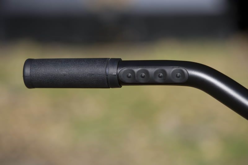

Exile does have some bars where he milled out the bars just behind the grip and inserted the grip ace pad. (will post pic soon as I get it loaded) It's pretty sweet and you could use the twist clutch, which was what I was gonna do till it continued my research and found out to do it the right way and be effective and practical. You would need the twist clutch set up, a new stronger tranny cover, and a auto clutch packand maybe a few other small bits and pieces. and I'm still not even sure if you would have to switch to an open primary for the auto clutch set up. So all that puts up well past $2 bills just for the clutch set up alone. then you still needs your bars and such...

Old Feb 24, 2012 | 07:48 AM
Deadanimal's Avatar
Deadanimal
Joined: Dec 2011
Posts: 300
From: England, Feltwell area
If you see how the bars are just a little narrower than the grip, I'm having mine the same diamater grips and bars so they flow and look to be one.
