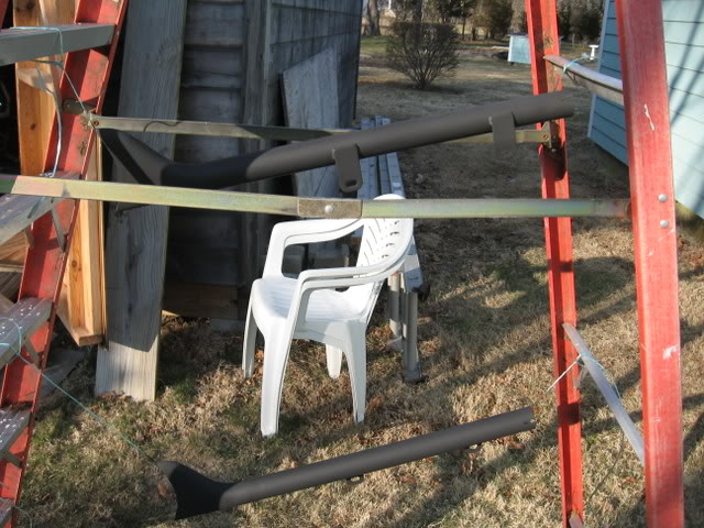

I had mine sandblasted and then sprayed them with High temp BBQ Krylon.
4 years and I haven't had to touch them up. Nice cheap solution.
You can have them professionally ceramic coated to with stand the heat

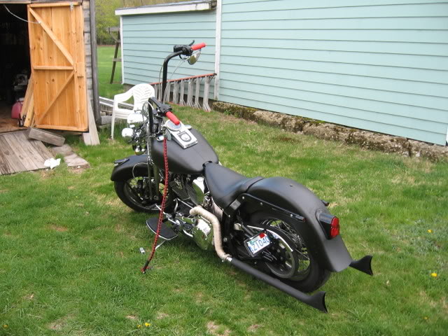

Another alternative would be Techline Coating's Black Satin (you have to apply it with a touch up paint spray gun).
I did my car's turbo hot side, exhaust manifold, and downpipe with it. It is holding on really well and whitstands very high temperatures.

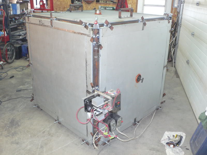

They say that the curing is done while the pipe is heated up from running the engine but I didn't take any chances and cured mine in my home made oven that I had built for powdercoating.
