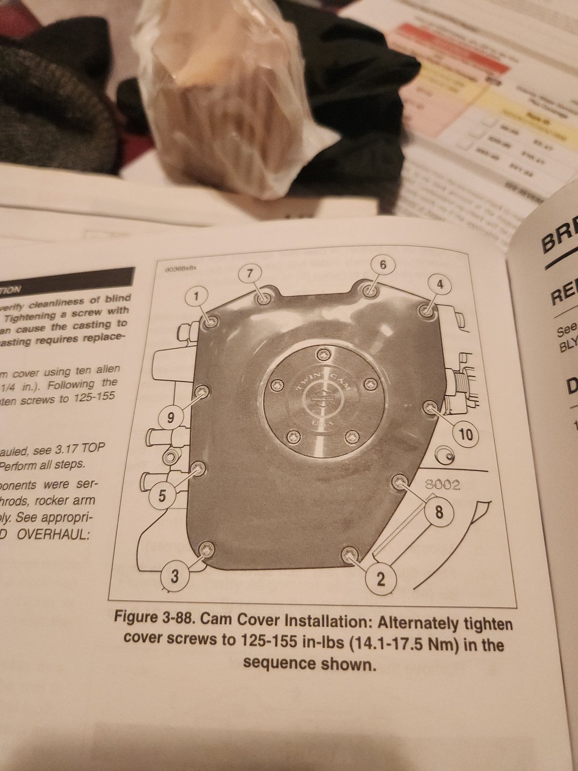

Default Cam cover specs.
From my 04 manual ..  04 Fatboy tc88

Re-check them after the first good run also.
Just adding my procedure when applying anti-sieze or thread lock. I use the min. torque specification to compensate for the lube factor on install.
