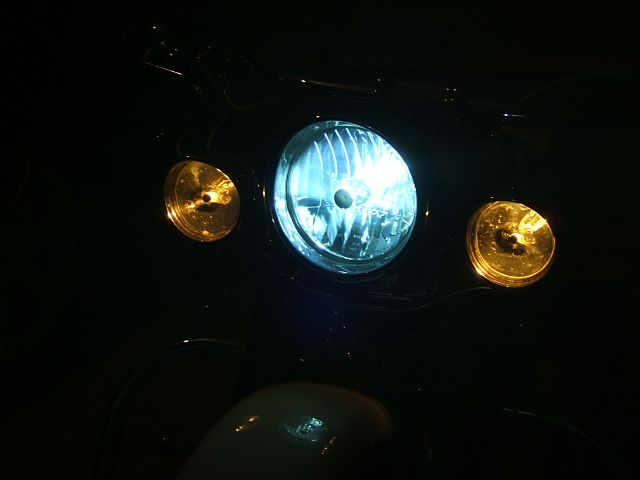

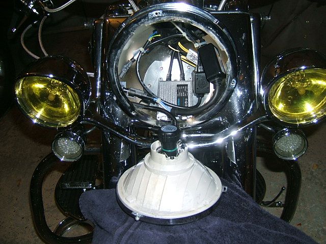

Well I thought I was going to do a write up on this but...basically you buy it, plug it all in and then put the lamp back in.
I did zip strip all of the harness together to keep stuff from rattling and I tacked down the ballast with some silicone to keep it from bouncing around. I used silicone in case it doesn't work out and I want to remove it and because its heat resistant.
The pic below doesn't do it justice, my camera is compensating for the brightness. I'm no photographer...
The High/Lo function works perfectly...all for the low price of $28

was it just the bulb? or is there some sort of power inverter that goes with it?

Its a AC ballast. Mini ballast, harness, bulb...thats all there is to it. Its all right there in the pic and fully self contained in the headlight can. No wires in or out. Plugs right in to the factory H4 plug.
Took 10 minutes

Additional info: ballast is 35W AC
Ignition peak amp less than 6A (fraction of a second) no fuse issues so far
Stable working load less than 3.7A
3200 lumens
